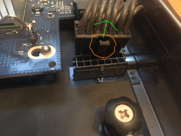

  9. 2006 Xserve Teardown, Backplane-to-Logic Board I/O Cable: 9 단계, 이미지 3개 중 1개 2006 Xserve Teardown, Backplane-to-Logic Board I/O Cable: 9 단계, 이미지 3개 중 2개 2006 Xserve Teardown, Backplane-to-Logic Board I/O Cable: 9 단계, 이미지 3개 중 3개
    • they are only press in connectors use a Spudger to pry one side, should come free after a little force
    • Carefull with the connecters as they can be damaged!
    • Note! there is adhesive on the side of the cable along the power module's side
