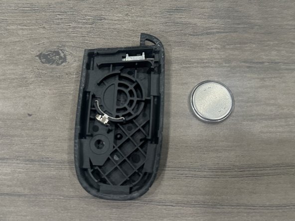

    • Use a nylon spudger to pry under the battery and remove it from the key fob.
  4. 2011-Present Dodge Charger Key Fob Battery Replacement: 4 단계, 이미지 1개 중 1개
    • Insert the new key fob battery into the holder.
    • You will hear a click sound when you push it into the holder.
