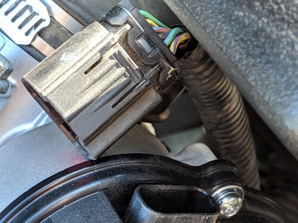

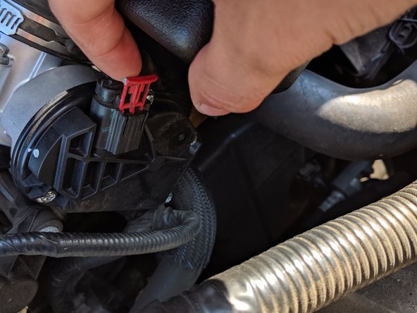

  3. 2012 Ford Fusion Throttle Body Replacement, Remove Throttle Body Plug: 5 단계, 이미지 3개 중 1개 2012 Ford Fusion Throttle Body Replacement, Remove Throttle Body Plug: 5 단계, 이미지 3개 중 2개 2012 Ford Fusion Throttle Body Replacement, Remove Throttle Body Plug: 5 단계, 이미지 3개 중 3개
    • Disconnect the electronic plug on the front of the throttle body.
    • Note: There may be a red safety clip on the plug, it is easily removed by pulling straight upwards on it then the plug can be compressed and removed.
