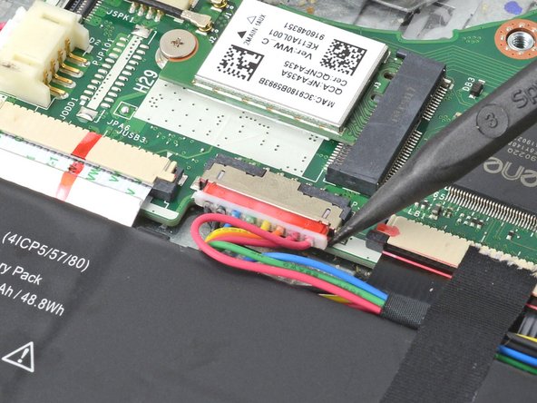

  10. Acer Aspire A515-51G SSD Replacement, Disconnect the battery: 10 단계, 이미지 3개 중 1개 Acer Aspire A515-51G SSD Replacement, Disconnect the battery: 10 단계, 이미지 3개 중 2개 Acer Aspire A515-51G SSD Replacement, Disconnect the battery: 10 단계, 이미지 3개 중 3개
    • Use the pointed end of a spudger to push each side of the battery connector until it comes out of the socket.
