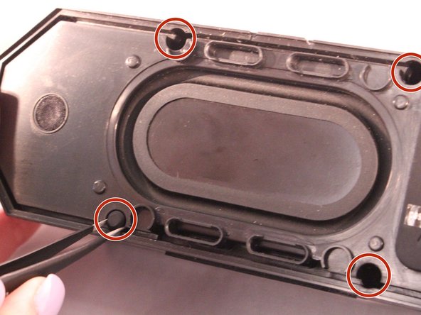

    • Using tweezers remove the rubber stoppers (4 at the back + 2 at the front).

    • Using the size PH1 screwdriver remove the screws exposed from the rubber stoppers (4 + 2).
