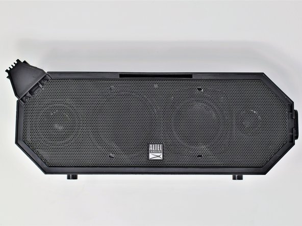

    • Use your hands to remove the pegs (4) located on both sides of the speaker.

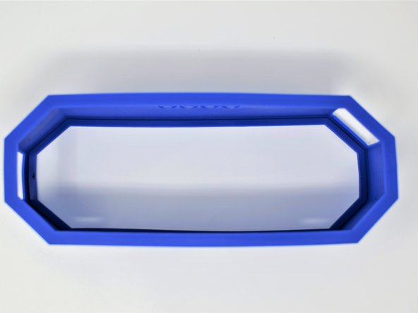

    • Remove the outer black rubber housing of the speaker.
  3. Altec Lansing Super Life Jacket Speaker Handle Replacement: 3 단계, 이미지 3개 중 1개 Altec Lansing Super Life Jacket Speaker Handle Replacement: 3 단계, 이미지 3개 중 2개 Altec Lansing Super Life Jacket Speaker Handle Replacement: 3 단계, 이미지 3개 중 3개
    • Remove the inner blue rubber housing from the speaker.

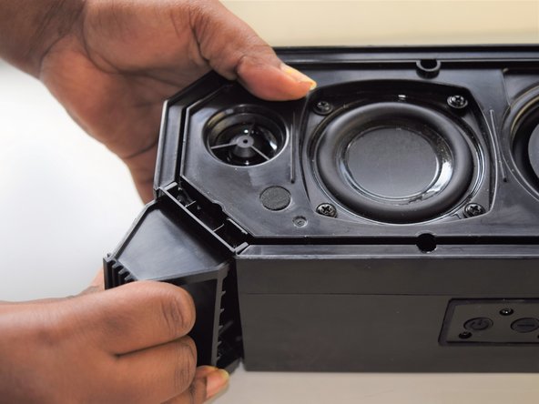

    • Remove the 4 7.8mm Phillips screws on the speaker cover using the PH0 screwdriver.
  5. Altec Lansing Super Life Jacket Speaker Handle Replacement: 5 단계, 이미지 2개 중 1개 Altec Lansing Super Life Jacket Speaker Handle Replacement: 5 단계, 이미지 2개 중 2개
    • Carefully slide the handle off the speaker but pushing upwards to the direction the handle is facing.
