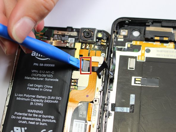

  3. Amazon Fire Phone Headphone Jack Replacement, Manual Opening: 3 단계, 이미지 3개 중 1개 Amazon Fire Phone Headphone Jack Replacement, Manual Opening: 3 단계, 이미지 3개 중 2개 Amazon Fire Phone Headphone Jack Replacement, Manual Opening: 3 단계, 이미지 3개 중 3개
    • Press the single suction cup just above the home button.
    • While lifting up on the suction cup place the plastic opening tool at the rim of the screen, separating the screen from the back casing.
    • Carefully separate the two halves to avoid tearing the volume rocker ribbon cable.
    • Using the opening tool, disconnect the volume rocker ribbon cable from the base of the phone, freeing the two halves.
  4. Amazon Fire Phone Headphone Jack Replacement: 4 단계, 이미지 3개 중 1개 Amazon Fire Phone Headphone Jack Replacement: 4 단계, 이미지 3개 중 2개 Amazon Fire Phone Headphone Jack Replacement: 4 단계, 이미지 3개 중 3개
    • Remove the 1mm screw concealed in the headphone jack.
    • Afterwards the headphone jack will easily pop off.
