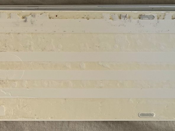

    • For opening I recommend to use a sharp knife to cut the glue. I could cut less than a mm at once, so you have to do it many times and be careful!
    • Please note that the plastic is not acid resistant.. so don't try to have a good idea like me to use Aceton... :/

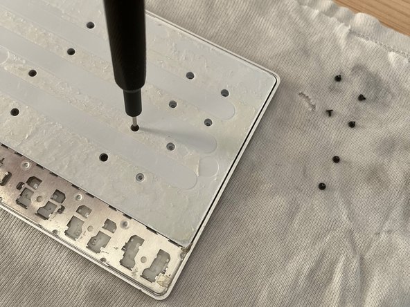

  2. Apple Magic Keyboard Disassembly: 3 단계, 이미지 3개 중 1개 Apple Magic Keyboard Disassembly: 3 단계, 이미지 3개 중 2개 Apple Magic Keyboard Disassembly: 3 단계, 이미지 3개 중 3개
    • After that you will find some screws.. 33 :)
    • They are all identical, so do not worry about mixing them up.

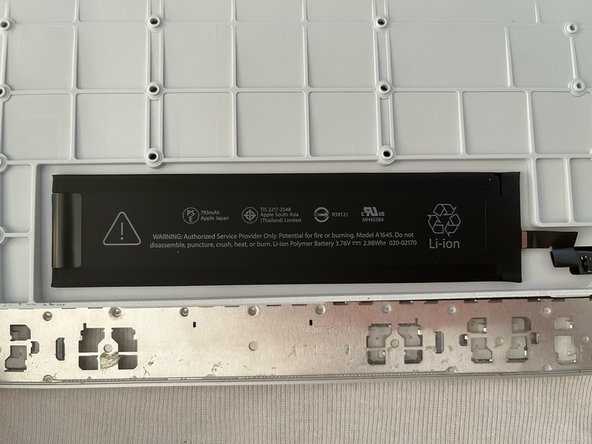

  4. Apple Magic Keyboard Disassembly: 5 단계, 이미지 2개 중 1개 Apple Magic Keyboard Disassembly: 5 단계, 이미지 2개 중 2개
    • Oh what for a sweet battery..
    • 793mAh.. 3.76V Model: A1645
    • So.. Apple makes it very easy to swap the battery buuut.. it's honestly not such a great deal :D

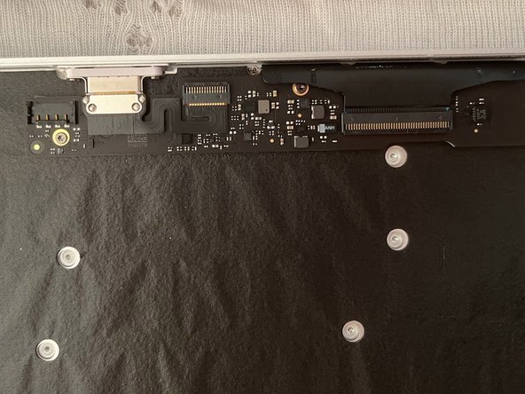

  5. Apple Magic Keyboard Disassembly: 6 단계, 이미지 2개 중 1개 Apple Magic Keyboard Disassembly: 6 단계, 이미지 2개 중 2개
    • Nice lightning connector.. but it's not that spectacular..

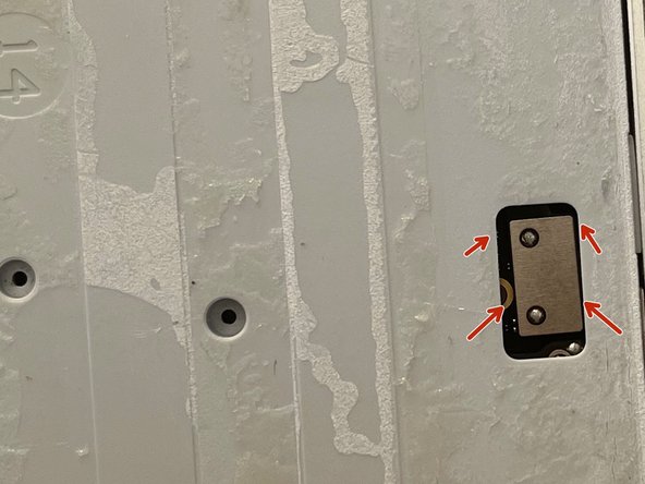

  6. Apple Magic Keyboard Disassembly: 7 단계, 이미지 2개 중 1개 Apple Magic Keyboard Disassembly: 7 단계, 이미지 2개 중 2개
    • This plastic film has not really a function.. probably Apple engineers found it funny to ad it..
