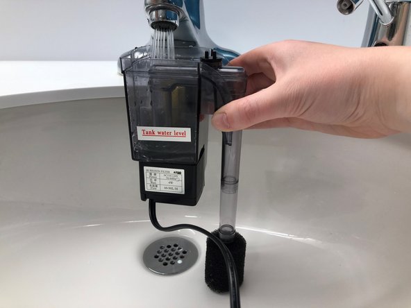

    • Remove the filter lid by pulling upwards.

    • Drain the filter completely of water.

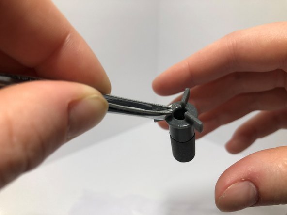

    • Pick up the new impeller using tweezers.
  12. Aquarium Filter Impeller Replacement: 12 단계, 이미지 3개 중 1개 Aquarium Filter Impeller Replacement: 12 단계, 이미지 3개 중 2개 Aquarium Filter Impeller Replacement: 12 단계, 이미지 3개 중 3개
    • Lower the new impeller into the cavity so that the shaft runs through the center of the impeller.
    • The impeller should immediately magnetize.

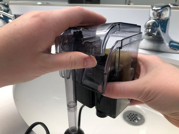

    • Refill the filter compartment to the water line.
    • The water line is indicated on side of the filter labelled as "Tank water level."
  17. Aquarium Filter Impeller Replacement: 17 단계, 이미지 3개 중 1개 Aquarium Filter Impeller Replacement: 17 단계, 이미지 3개 중 2개 Aquarium Filter Impeller Replacement: 17 단계, 이미지 3개 중 3개
    • Press the lid into the grooves on top of the filter.
