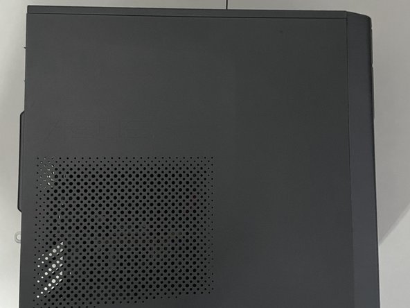

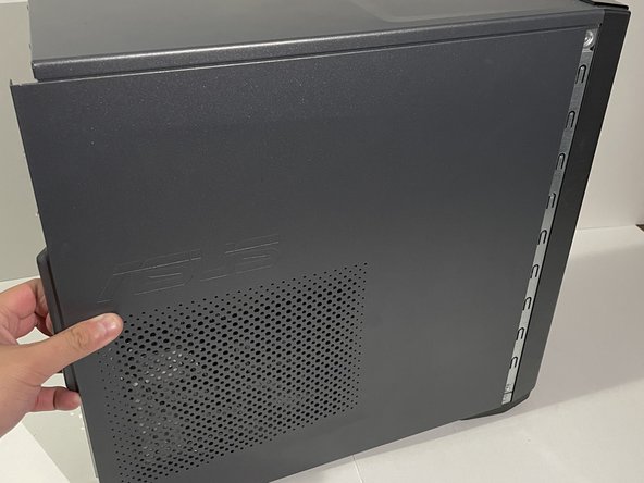

    • The side panel is located on the left side of the computer.
    • The 2nd image shows the correct side we will be working on.

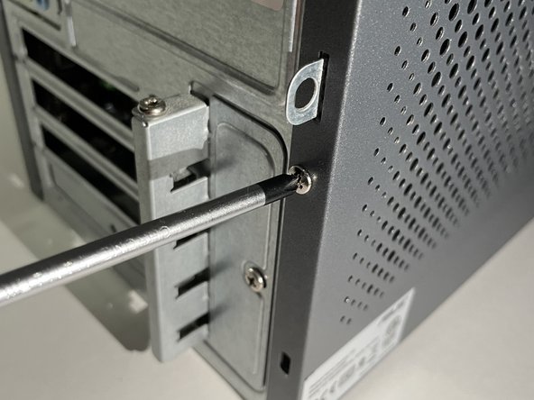

    • Face the back of the desktop towards you on a flat work service.
    • Use the Phillips #00 to remove the two 3.5 mm screws on the edge of the side panel.

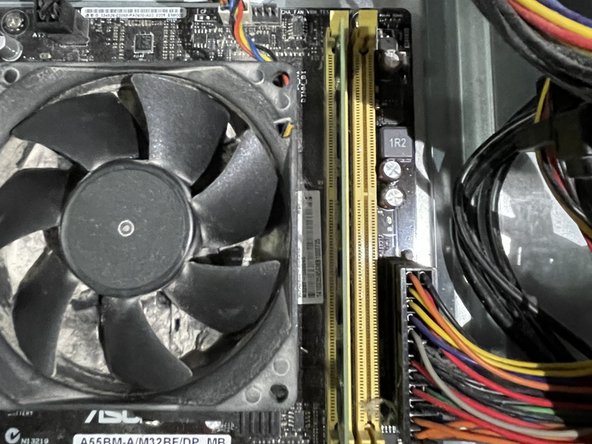

    • Locate the RAM modules.
    • They are thin, long, green, and rectangle shaped.

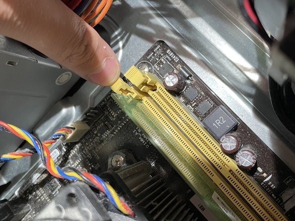

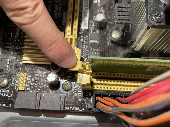

    • Unlock the locks that are holding the RAM module down, by pushing them downwards.
    • Although not shown in the first picture, there is also a lock at the bottom and can be seen on picture 3.
  6. Asus M32BF-US002T RAM Replacement: 6 단계, 이미지 2개 중 1개 Asus M32BF-US002T RAM Replacement: 6 단계, 이미지 2개 중 2개
    • Pull the RAM straight out.
    • Wiggling the RAM out of its slot may cause damage to the RAM module, or the RAM slot itself. Pull straight out!

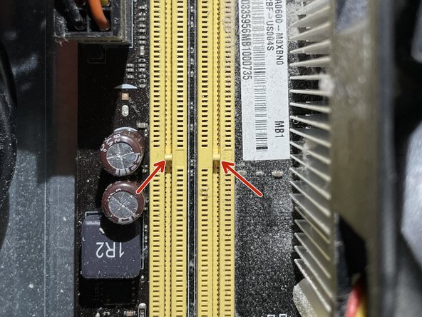

    • Before installing the new RAM, ensure the slots have been unlocked as seen in this picture.
    • You can tell it is unlocked when the lock looks like it has been pushed away from the slot.
    • If you are adding an additional RAM module, ensure the 2nd RAM slot is unlocked as well.

    • Before installing, ensure the gap on the RAM module aligns with the notch on the RAM slot.
