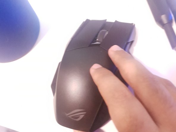

    • Make sure the mouse is powered off.
    • If the green is visible like in the first photo, turn the switch to fully power down the device.

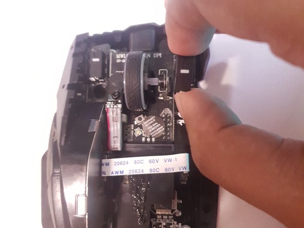

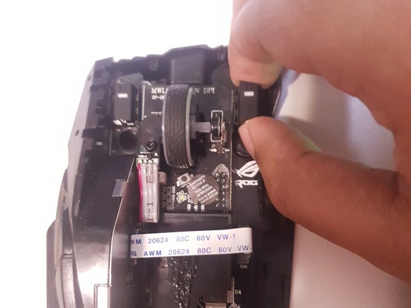

  5. Asus ROG Spatha Switch Replacement: 5 단계, 이미지 1/3 Asus ROG Spatha Switch Replacement: 5 단계, 이미지 2/3 Asus ROG Spatha Switch Replacement: 5 단계, 이미지 3/3
    • After locating which switch you need to replace, grab the switch by the top and the bottom and carefully pull it out of the device.
