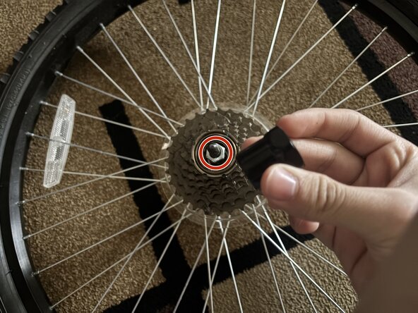

    • Before you begin, remove the rear wheel from your bike.
    • Place the freewheel removal tool onto the notches of the freewheel.
  2. Bicycle Freewheel Replacement: 2 단계, 이미지 1개 중 1개
    • Use an adjustable wrench to turn the freewheel removal tool counter-clockwise to loosen the freewheel.

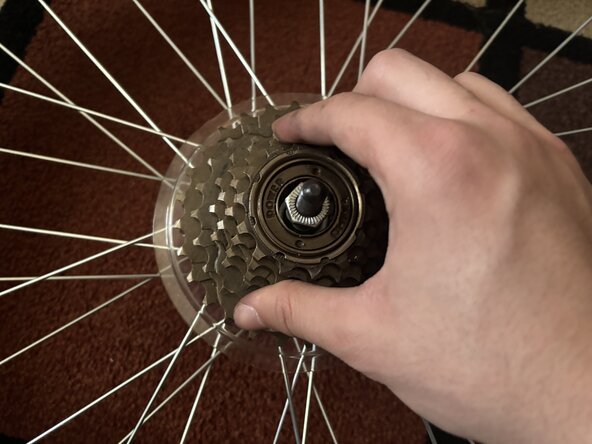

  3. Bicycle Freewheel Replacement: 3 단계, 이미지 3개 중 1개 Bicycle Freewheel Replacement: 3 단계, 이미지 3개 중 2개 Bicycle Freewheel Replacement: 3 단계, 이미지 3개 중 3개
    • When it's loose, remove the freewheel by hand.

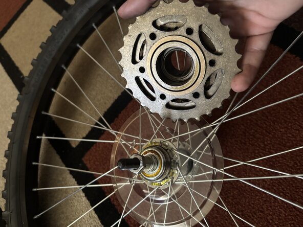

  4. Bicycle Freewheel Replacement: 4 단계, 이미지 1개 중 1개
    • Carefully examine the hub threads for any signs of damage or wear, such as cross-threading or debris.
    • Before installing the new freewheel, apply a light coat of grease or anti-seize lubricant to prevent future issues and ensure smooth installation.
  5. Bicycle Freewheel Replacement: 5 단계, 이미지 2개 중 1개 Bicycle Freewheel Replacement: 5 단계, 이미지 2개 중 2개
    • Install the new freewheel by spinning it with your hand clockwise until it is snug.
    • You should not feel any tension as this is a sign of cross-threading.
