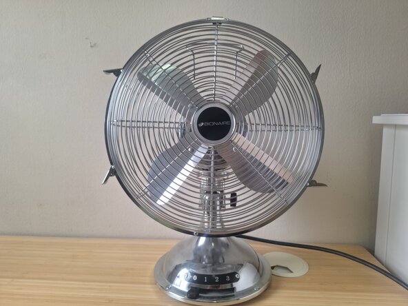

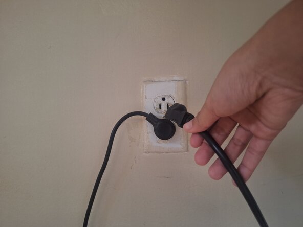

    • Unplug the fan and switch it off.
  2. Bionaire BDF1214CR-CN Fan Blade Replacement: 2 단계, 이미지 3개 중 1개 Bionaire BDF1214CR-CN Fan Blade Replacement: 2 단계, 이미지 3개 중 2개 Bionaire BDF1214CR-CN Fan Blade Replacement: 2 단계, 이미지 3개 중 3개

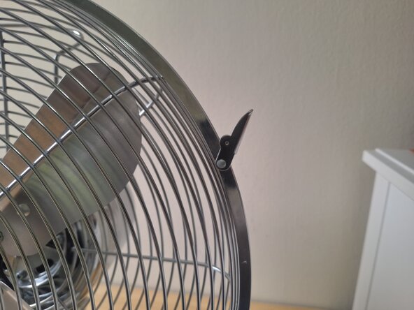

    • Flip open the clip locks positioned along the seam of the housing or cage.

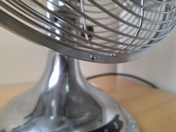

    • Use the Phillips #2 screwdriver to loosen the 7 mm screw at the bottom of the grill.
    • When the 7 mm Phillips #2 screw is loose, turn to the back of the fan and rotate the small bolt counterclockwise until it pops out.
    • Remove the 7 mm Phillips #2 screw.

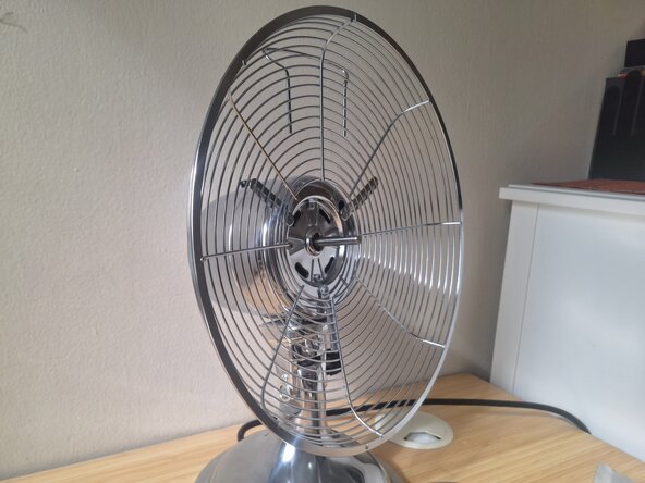

  4. Bionaire BDF1214CR-CN Fan Blade Replacement: 4 단계, 이미지 3개 중 1개 Bionaire BDF1214CR-CN Fan Blade Replacement: 4 단계, 이미지 3개 중 2개 Bionaire BDF1214CR-CN Fan Blade Replacement: 4 단계, 이미지 3개 중 3개
    • Lift the front housing upward to remove it from the fan.
    • You might need a little bit of force to remove it.
