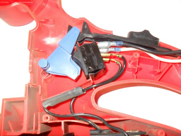

    • Locate the switch on the handle of the blower.
    • Carefully remove the four wires that are attached to the switch.
    • Use your hand to push in the sides of the switch and slide out the wires.
  5. Black and Decker BV2500 Type 4 Switch Replacement: 5 단계, 이미지 1/1
    • Note for reassembly: Be sure to put this back the way it was found.
