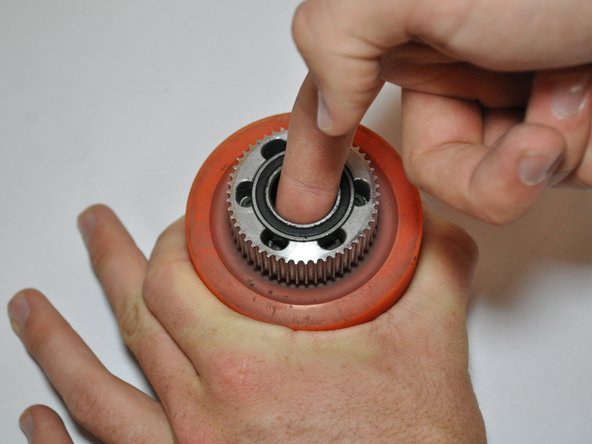

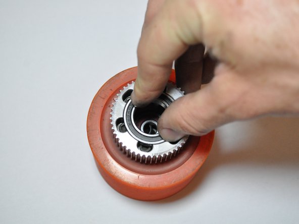

  5. Boosted Board 1st Generation Pulley Bearings Replacement, Pulley Bearings: 5 단계, 이미지 2개 중 1개 Boosted Board 1st Generation Pulley Bearings Replacement, Pulley Bearings: 5 단계, 이미지 2개 중 2개
    • Use one finger to pull out the pulley bearing.
    • A good technique is to go around in a circle and lift from underneath the bearing in a carving motion.

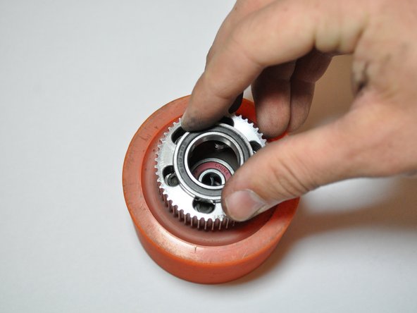

  6. Boosted Board 1st Generation Pulley Bearings Replacement: 6 단계, 이미지 3개 중 1개 Boosted Board 1st Generation Pulley Bearings Replacement: 6 단계, 이미지 3개 중 2개 Boosted Board 1st Generation Pulley Bearings Replacement: 6 단계, 이미지 3개 중 3개
    • Place the new pulley bearing inside the gear hole and use two fingers to push down evenly until it slides into place.
    • The bearing should be flush with the gear
