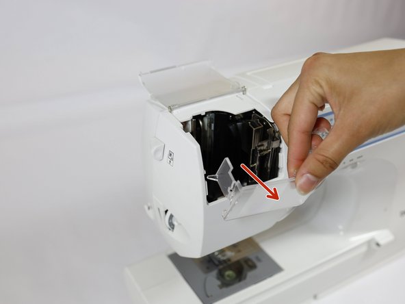

    • Open the thread compartment.
    • Press the back level on left side of the machine to eject the thread cassette compartment.
  12. Brother CS-80 Tire Ring Replacement: 12 단계, 이미지 3개 중 1개 Brother CS-80 Tire Ring Replacement: 12 단계, 이미지 3개 중 2개 Brother CS-80 Tire Ring Replacement: 12 단계, 이미지 3개 중 3개
    • Remove the thread cassette compartment by pulling it up.
    • Remove the front clear shield to the thread cassette compartment holder by pulling it away from the machine.

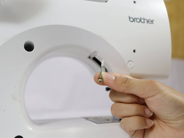

    • Remove the large 19 mm Phillips screw from the bottom right of the machine.
    • You should have removed a total of five 19 mm large screws from the back face.

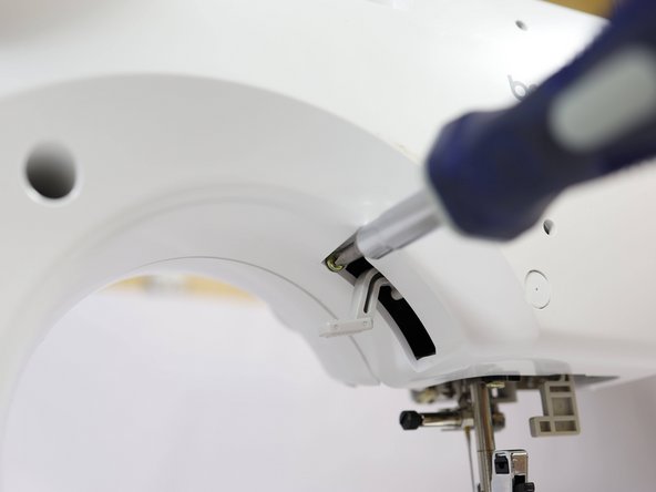

    • Remove the 33 mm Phillips head screw by the presser foot lever.

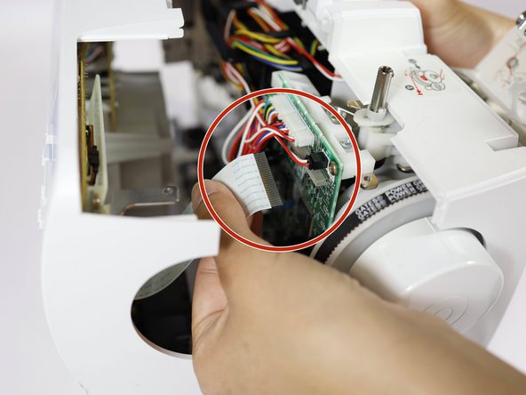

    • Gently disconnect the ribbon cable from the motherboard.
  21. Brother CS-80 Tire Ring Replacement: 21 단계, 이미지 2개 중 1개 Brother CS-80 Tire Ring Replacement: 21 단계, 이미지 2개 중 2개

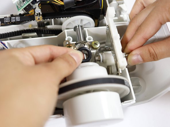

    • Use a flathead screwdriver to pry off the tire ring.
    • The tire ring may have disintegrated and deposited black rubber on the inside of the machine. If so, clean the area with cotton swabs damp with isopropyl alcohol and paper towels. Wearing disposable gloves is recommended.
  29. Brother CS-80 Tire Ring Replacement: 29 단계, 이미지 3개 중 1개 Brother CS-80 Tire Ring Replacement: 29 단계, 이미지 3개 중 2개 Brother CS-80 Tire Ring Replacement: 29 단계, 이미지 3개 중 3개
    • Place the new tire ring onto its seat.
    • You may need to use a flathead screwdriver to help it seat fully.
