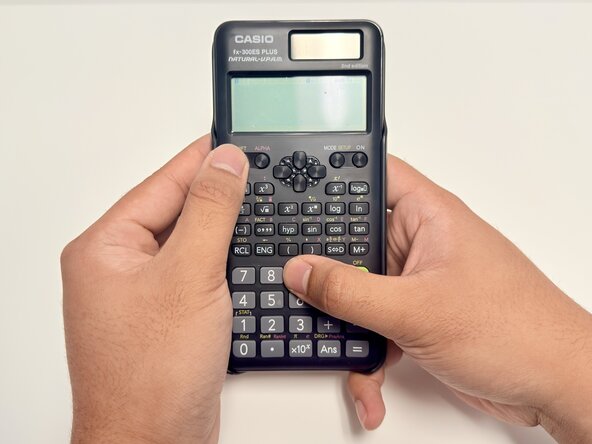

  1. Casio fx-300ES Plus 2nd Edition Battery Replacement, Battery Replacement: 1 단계, 이미지 1개 중 1개
    • Press (Shift + AC) to turn off the calculator.

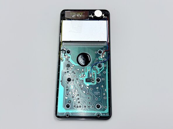

  2. Casio fx-300ES Plus 2nd Edition Battery Replacement: 2 단계, 이미지 3개 중 1개 Casio fx-300ES Plus 2nd Edition Battery Replacement: 2 단계, 이미지 3개 중 2개 Casio fx-300ES Plus 2nd Edition Battery Replacement: 2 단계, 이미지 3개 중 3개
    • Use a Phillips #00 screwdriver to remove the six 7.5 mm screws from the back panel.
    • Insert an opening pick in the seam between the top and bottom casing.
    • Slide it around the perimeter of the calculator to release the clips that connect the front and back panels.
    • Carefully separate the front and back halves of the calculator casing.

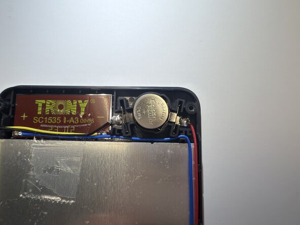

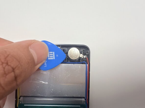

  3. Casio fx-300ES Plus 2nd Edition Battery Replacement: 3 단계, 이미지 3개 중 1개 Casio fx-300ES Plus 2nd Edition Battery Replacement: 3 단계, 이미지 3개 중 2개 Casio fx-300ES Plus 2nd Edition Battery Replacement: 3 단계, 이미지 3개 중 3개
    • Use a plastic spudger or opening pick to remove the old battery.

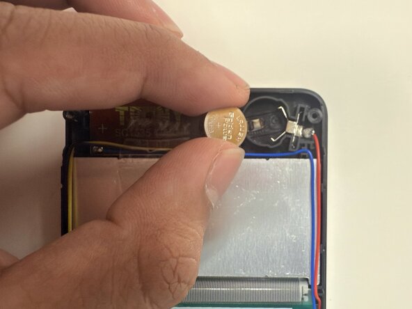

  4. Casio fx-300ES Plus 2nd Edition Battery Replacement: 4 단계, 이미지 1개 중 1개
    • Insert the new LR44 battery into the compartment with the positive (+) side facing up.

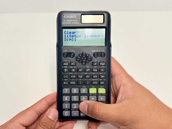

    • Power on the calculator, then bring up the 'clear' menu by pressing (SHIFT + 9).
  7. Casio fx-300ES Plus 2nd Edition Battery Replacement: 7 단계, 이미지 3개 중 1개 Casio fx-300ES Plus 2nd Edition Battery Replacement: 7 단계, 이미지 3개 중 2개 Casio fx-300ES Plus 2nd Edition Battery Replacement: 7 단계, 이미지 3개 중 3개

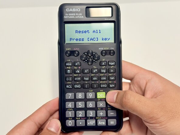

    • Perform a restoration of the calculator's default settings.
    • The order to press is (SHIFT, 9, 1, =).
