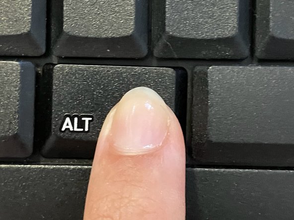

Cherry Stream Desktop - Low Profile Keycap - Repair
  1. Cherry Stream Desktop - Low Profile Keycap - Repair, Place components on a flat surface: 1 단계, 이미지 2개 중 1개 Cherry Stream Desktop - Low Profile Keycap - Repair, Place components on a flat surface: 1 단계, 이미지 2개 중 2개
    • Image 1: Put the 3 components on a flat surface. The keycap (black component)
    • Image 2: the 2-component bracket

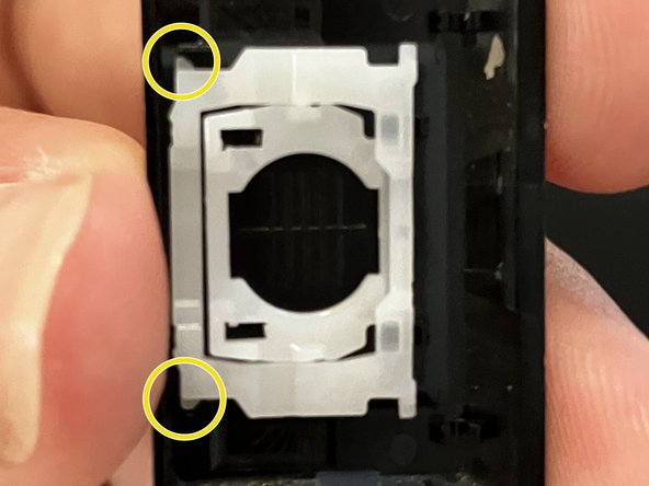

  3. Cherry Stream Desktop - Low Profile Keycap - Repair, Join the small with the larger bracket: 3 단계, 이미지 2개 중 1개 Cherry Stream Desktop - Low Profile Keycap - Repair, Join the small with the larger bracket: 3 단계, 이미지 2개 중 2개
    • Image 1: Insert the pin of the small bracket onto the larger one.
    • Note: There are two small pins. Ideally, you should insert both. One after the other. But if one breaks, the keycap will still work.
    • Image 2: Just place the larger bracket on the keycap. There is no click

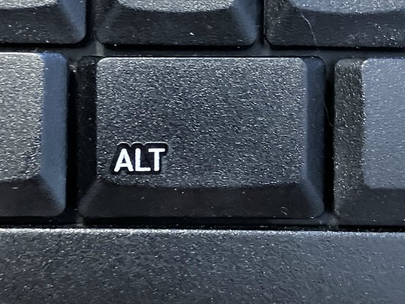

  4. Cherry Stream Desktop - Low Profile Keycap - Repair, The final touch: 4 단계, 이미지 3개 중 1개 Cherry Stream Desktop - Low Profile Keycap - Repair, The final touch: 4 단계, 이미지 3개 중 2개 Cherry Stream Desktop - Low Profile Keycap - Repair, The final touch: 4 단계, 이미지 3개 중 3개
    • Image 1: you need to orient the keycap so that it can click to the tiny metal bar
    • Note: This is just a reference
    • Image 2: Once oriented, place the keycap on top of the space for the keycap on the keyboard, while holding the white bracket.
    • Next, simply press the keycap down
    • Image 3: Congratulations! Your keyboard should be working again. :D
