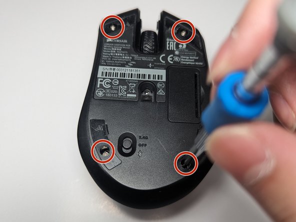

    • Use a Phillips #0 screwdriver to remove the four 9 mm-long screws under the feet.

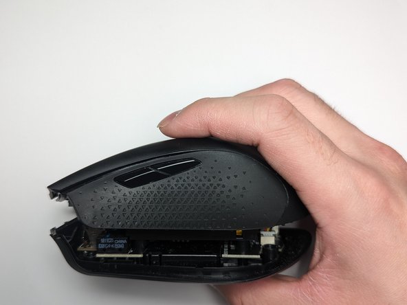

    • Use a spudger to pry along the seam between top and bottom of the mouse.
    • Gently separate the top and bottom case until you can see the internals of the mouse.

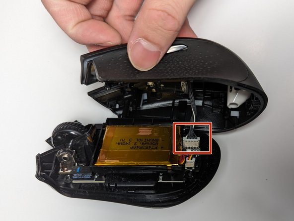

    • Do not fully remove the top cover as it is connected by a cable and will damage the mouse.
    • Use the point of a spudger to push on alternating sides of the connector to "walk" it out of its socket and remove the cable attaching the top and bottom of the mouse.

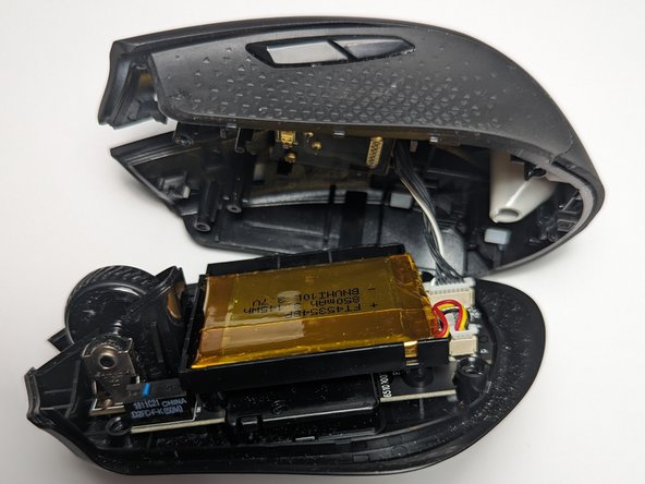

    • Use the point of a spudger or opening pick to push on alternating sides of the battery connector to "walk" it out of its socket and remove the battery cable.
    • Use a spudger and wedge it between the battery and the mouse.
    • Work the spudger left and right to slowly lift the adhesive.
    • Do not poke the spudger into the battery.
    • Once it is loose, lift and remove the battery.
