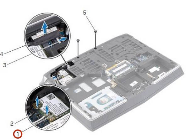

  44. Dell Alienware 14 Display Assembly Replacement, Disconnecting the Display: 50 단계, 이미지 1개 중 1개
    • Disconnect the display and camera cables from the system-board connectors.
  45. Dell Alienware 14 Display Assembly Replacement, Disconnect the Antenna Cables: 51 단계, 이미지 2개 중 1개 Dell Alienware 14 Display Assembly Replacement, Disconnect the Antenna Cables: 51 단계, 이미지 2개 중 2개
    • Disconnect the antenna cables from the wireless mini-card.
  46. Dell Alienware 14 Display Assembly Replacement, Remove the Screws: 52 단계, 이미지 1개 중 1개
    • Remove the screws that secure the display assembly to the computer base.
