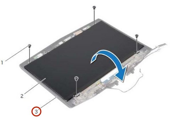

  68. Dell Alienware 14 Display Panel Replacement, Remove the Screws: 74 단계, 이미지 1개 중 1개
  69. Dell Alienware 14 Display Panel Replacement, Placing the Display Back-Cover: 75 단계, 이미지 2개 중 1개 Dell Alienware 14 Display Panel Replacement, Placing the Display Back-Cover: 75 단계, 이미지 2개 중 2개
    • Carefully turn the display panel over and place it on the display back-cover.

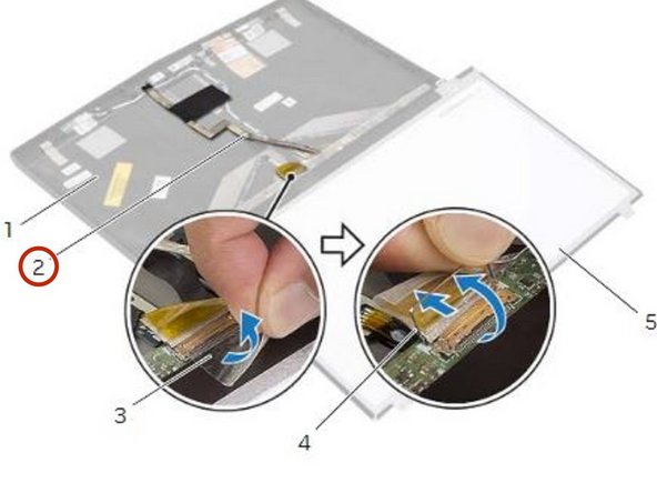

  70. Dell Alienware 14 Display Panel Replacement, Peeling the Tape: 76 단계, 이미지 2개 중 1개 Dell Alienware 14 Display Panel Replacement, Peeling the Tape: 76 단계, 이미지 2개 중 2개
    • Peel the tape that secures the display cable to the display-panel connector.
  71. Dell Alienware 14 Display Panel Replacement, Lifting the Connector Latch: 77 단계, 이미지 3개 중 1개 Dell Alienware 14 Display Panel Replacement, Lifting the Connector Latch: 77 단계, 이미지 3개 중 2개 Dell Alienware 14 Display Panel Replacement, Lifting the Connector Latch: 77 단계, 이미지 3개 중 3개
    • Lift the connector latch and disconnect the display cable from the display-panel connector.

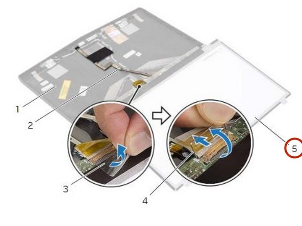

  72. Dell Alienware 14 Display Panel Replacement, Lifting the Display Panel: 78 단계, 이미지 2개 중 1개 Dell Alienware 14 Display Panel Replacement, Lifting the Display Panel: 78 단계, 이미지 2개 중 2개
    • Lift the display panel off the display back-cover.
