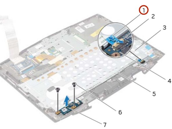

  43. Dell Alienware 14 Power-Button Board Replacement, Disconnecting the Power-Button Board Cable: 49 단계, 이미지 3개 중 1개 Dell Alienware 14 Power-Button Board Replacement, Disconnecting the Power-Button Board Cable: 49 단계, 이미지 3개 중 2개 Dell Alienware 14 Power-Button Board Replacement, Disconnecting the Power-Button Board Cable: 49 단계, 이미지 3개 중 3개
    • WARNING: Before working inside your computer, read the safety information that shipped with your computer and follow the steps in Before Working Inside Your Computer. After working inside your computer, follow the instructions in After Working Inside Your Computer.
    • Lift the connector latch and disconnect the power-button board cable from the connector on the status-light board.

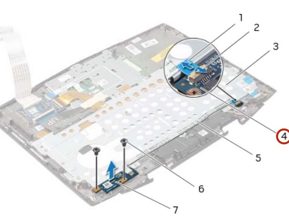

  44. Dell Alienware 14 Power-Button Board Replacement, Peeling the Power-Button Board Cable: 50 단계, 이미지 2개 중 1개 Dell Alienware 14 Power-Button Board Replacement, Peeling the Power-Button Board Cable: 50 단계, 이미지 2개 중 2개
    • Make a note of the power-button board cable routing and peel off the power-button board cable from the keyboard bracket.
  45. Dell Alienware 14 Power-Button Board Replacement, Remove the Screws: 51 단계, 이미지 1개 중 1개
    • Remove the screws that secure the power-button board to the palm-rest assembly.
  46. Dell Alienware 14 Power-Button Board Replacement, Lifting the Power-Button Board: 52 단계, 이미지 1개 중 1개
    • Lift the power-button board along with its cable off the palm-rest assembly.
  47. Dell Alienware 14 Power-Button Board Replacement, Align the Screw Holes: 53 단계, 이미지 1개 중 1개
    • Align the screw holes on the NEW power-button board with the screw holes on the palm-rest assembly.
  48. Dell Alienware 14 Power-Button Board Replacement, Replace the Screws: 54 단계, 이미지 1개 중 1개
    • Replace the screws that secure the power-button board to the palm-rest assembly.
  49. Dell Alienware 14 Power-Button Board Replacement, Route the Power-Button Board: 55 단계, 이미지 1개 중 1개
    • Route the power-button board cable on the keyboard bracket and adhere the cable to the keyboard bracket.
  50. Dell Alienware 14 Power-Button Board Replacement, Slide the Power-Button Board Cable: 56 단계, 이미지 2개 중 1개 Dell Alienware 14 Power-Button Board Replacement, Slide the Power-Button Board Cable: 56 단계, 이미지 2개 중 2개
    • Slide the power-button board cable into the status-light board connector and press down on the connector latch to secure the cable.
