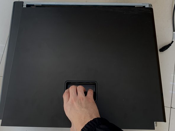

    • Open the case using the handle on the side.
    • Locate the CPUs.
    • The two black boxes are radiators, the CPUs are under these two black boxes.
