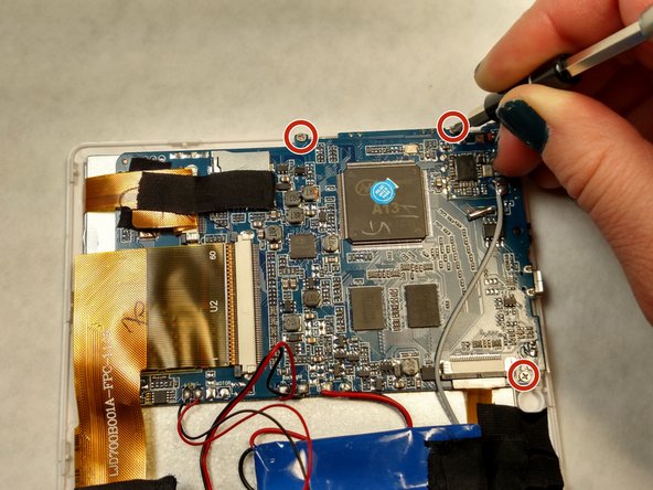

  3. Dragon Touch MID 7138 Motherboard Replacement, Motherboard: 3 단계, 이미지 3개 중 1개 Dragon Touch MID 7138 Motherboard Replacement, Motherboard: 3 단계, 이미지 3개 중 2개 Dragon Touch MID 7138 Motherboard Replacement, Motherboard: 3 단계, 이미지 3개 중 3개
    • Remove tape covering wire joints
    • Remove (3) 2.5mm screws using a PH001 screw driver.
    • The screws locations are highlighted in the image to the left.

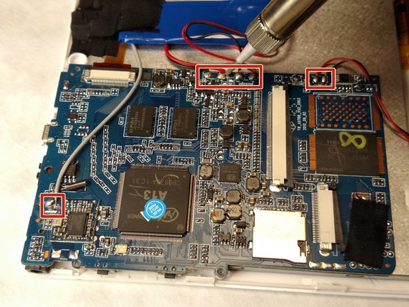

  7. Dragon Touch MID 7138 Motherboard Replacement: 7 단계, 이미지 2개 중 1개 Dragon Touch MID 7138 Motherboard Replacement: 7 단계, 이미지 2개 중 2개
    • Desolder the wires attached to the mother board with a soldering iron.
    • Then pull the wires from the joints.
