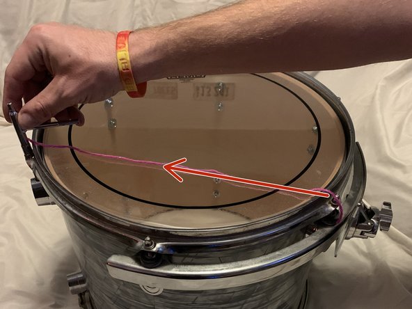

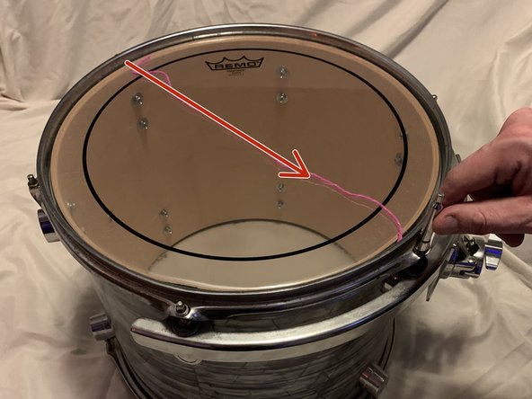

  5. Drum Head Replacement: 5 단계, 이미지 3개 중 1개 Drum Head Replacement: 5 단계, 이미지 3개 중 2개 Drum Head Replacement: 5 단계, 이미지 3개 중 3개
    • Begin to tighten the tension rods in a star pattern using a drum key.
    • Do not tighten the tension rods in a clockwise or counter clockwise pattern.
    • Tighten the rods until you find the sound you want from the drum.
