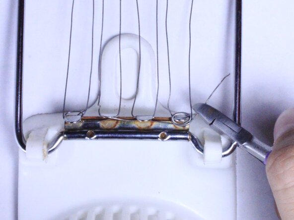

    • Using the flat nosed pliers, pry the clamp open.
    • Grip the clamp and bend to a 90 degree angle.
    • Repeat this step for every clamp.

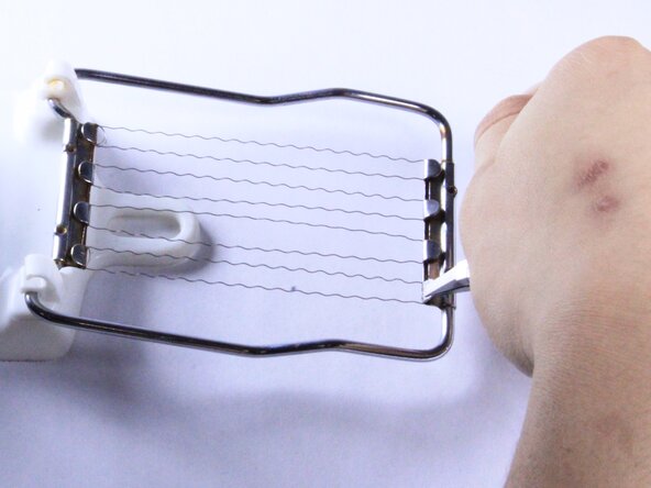

  2. Egg Slicer Wire Replacement: 2 단계, 이미지 1개 중 1개
    • Unwind the old wire from the slicer.
    • Extend the wire and put to the side.
    • You should now be left with the skeleton of the egg slicer.

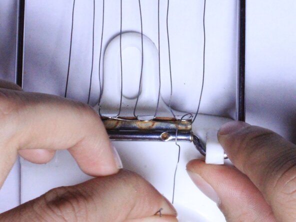

  4. Egg Slicer Wire Replacement: 4 단계, 이미지 2개 중 1개 Egg Slicer Wire Replacement: 4 단계, 이미지 2개 중 2개
    • Take the new wire, and anchor it by tying it in a loop around one of the clamp.
    • Pull the wire as tight as possible to the right side of clamp.
  5. Egg Slicer Wire Replacement: 5 단계, 이미지 3개 중 1개 Egg Slicer Wire Replacement: 5 단계, 이미지 3개 중 2개 Egg Slicer Wire Replacement: 5 단계, 이미지 3개 중 3개
    • Loop the wire tightly around the clamp.
    • Rotate the wire in a counterclockwise direction.
    • When you reach the clamp across from it, loop it around the clamp, and pull the wire to clamp to the right of it.
    • Repeat these steps until you reach the final clamp.
