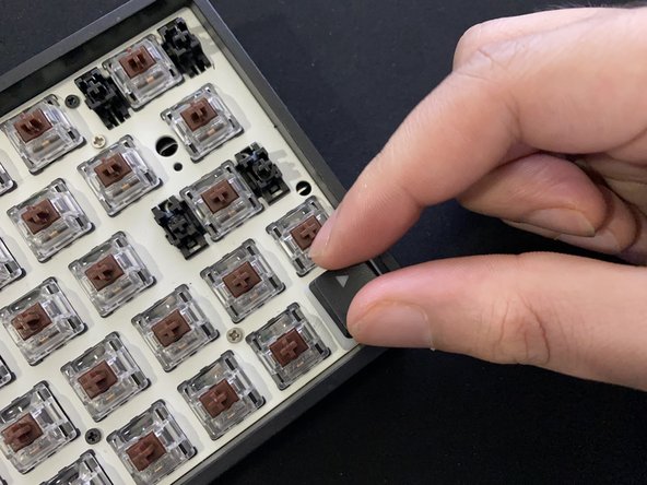

  2. Epomaker SK64S Keyboard Switches Replacement: 2 단계, 이미지 3개 중 1개 Epomaker SK64S Keyboard Switches Replacement: 2 단계, 이미지 3개 중 2개 Epomaker SK64S Keyboard Switches Replacement: 2 단계, 이미지 3개 중 3개
    • Align the keycap puller with the keycap.
    • Pull the keycap straight out.
    • Remove all of the keys.

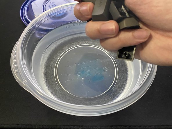

    • Fill the plastic container with water.
    • Add two drops of dish soap.

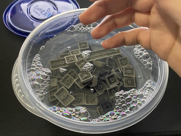

    • Put in the keycaps.
    • Let the keycaps soak for 30 minutes.

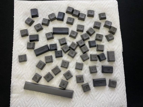

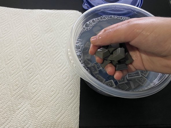

    • Take the keycaps out.
    • Place them on a paper towel.
    • Let the keycaps dry out.

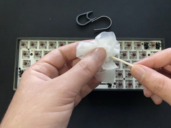

    • Use an alcohol wipe to soak the cotton swab.
    • Clean the board by running the cotton swab along the board.

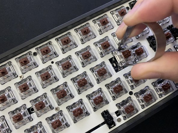

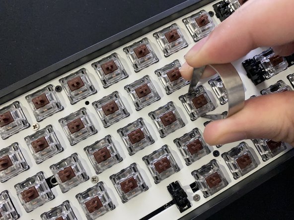

    • Align the switch puller with the faulty switch.
    • Pull the switch straight out.

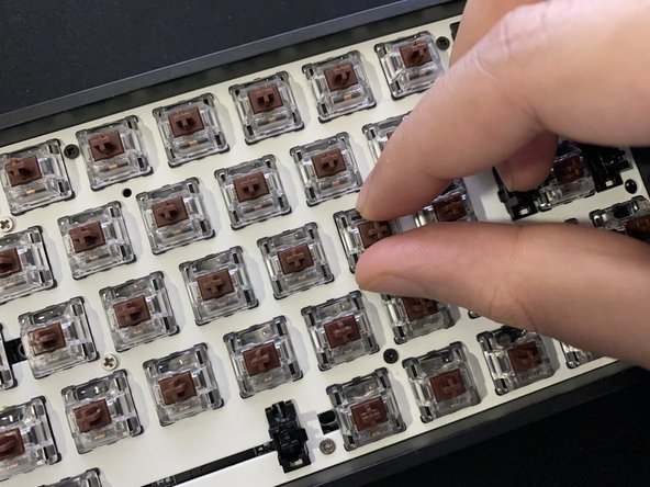

    • Align the new key switch.
    • Push the key switch straight down.

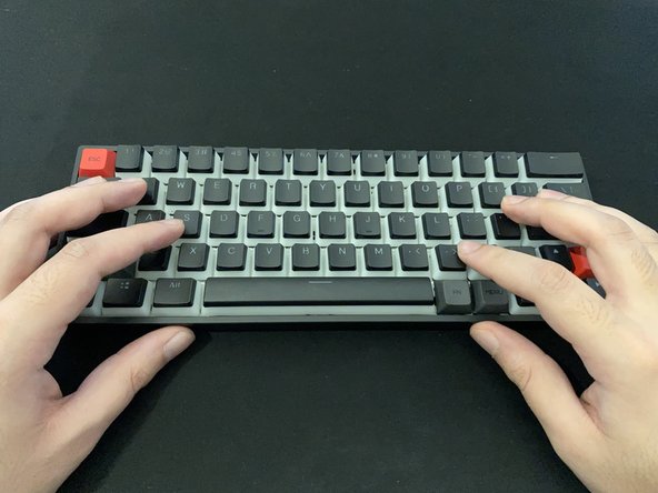

    • Align the keycap.
    • Push the keycap straight down.
    • Replace all the keycaps.
결론
Type away!
