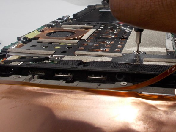

    • Remove the tape covering the metal shield as shown in the image.
    • Remove the 12 screws using the Phillips #00 screwdriver.
    • Dislodge the shield by pulling the prongs away from underneath the battery. The shield should come completely off.
