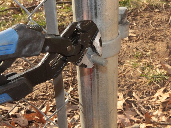

    • Use your open end wrench or pliers to loosen and remove the nuts on the bottom tension band.
    • It's important to begin with the bottom band, as removing the top band first will put pressure on the bottom band and make it harder to unscrew.
    • Loosen and remove top tension band.
    • Remove and place gate to the side.
