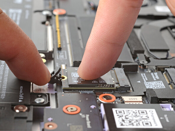

  7. Framework Laptop 12 SSD Clip Replacement, Unlatch the SSD: 7 단계, 이미지 2개 중 1개 Framework Laptop 12 SSD Clip Replacement, Unlatch the SSD: 7 단계, 이미지 2개 중 2개
    • Use your finger to press down on the black SSD latch to unlatch the SSD.
    • The SSD will pop up to an angle when it's unlatched.

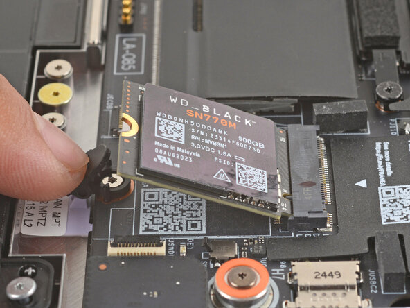

  8. Framework Laptop 12 SSD Clip Replacement, Remove the SSD: 8 단계, 이미지 3개 중 1개 Framework Laptop 12 SSD Clip Replacement, Remove the SSD: 8 단계, 이미지 3개 중 2개 Framework Laptop 12 SSD Clip Replacement, Remove the SSD: 8 단계, 이미지 3개 중 3개
    • Grab the SSD by its edges and pull it out of its socket.
    • Remove the SSD.

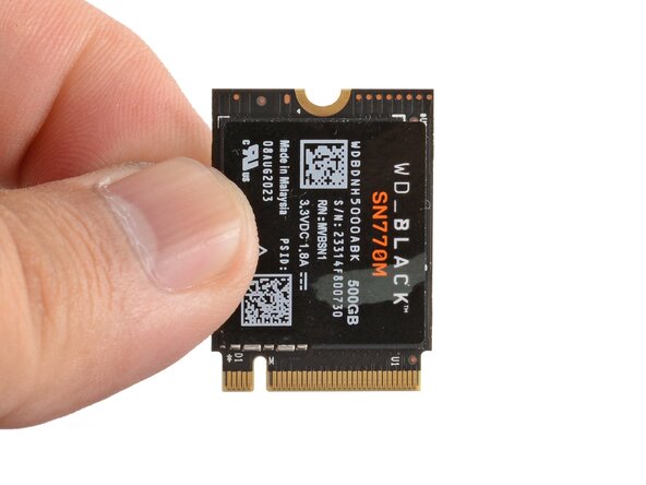

  14. Framework Laptop 12 SSD Clip Replacement, Install the SSD: 14 단계, 이미지 2개 중 1개 Framework Laptop 12 SSD Clip Replacement, Install the SSD: 14 단계, 이미지 2개 중 2개
    • Hold the SSD by its edges. Don't touch the gold contacts with your fingers. If you do, wipe the contacts with a clean, lint-free cloth to remove any finger oils.
    • Align the SSD's gold contacts with its socket.
    • Insert the SSD into the socket at a shallow angle. The gold contacts should mostly be covered by the socket.
    • The SSD fits into the socket in one orientation. If it doesn't feel like it fits, try flipping the module.

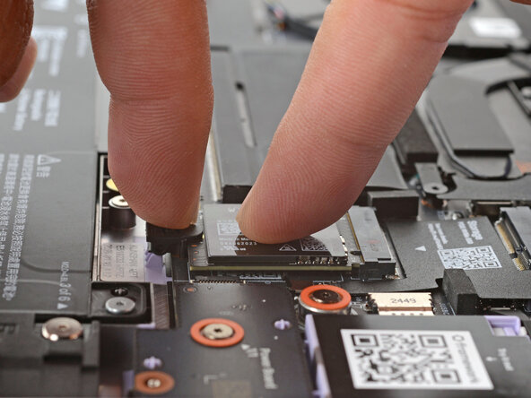

  15. Framework Laptop 12 SSD Clip Replacement: 15 단계, 이미지 3개 중 1개 Framework Laptop 12 SSD Clip Replacement: 15 단계, 이미지 3개 중 2개 Framework Laptop 12 SSD Clip Replacement: 15 단계, 이미지 3개 중 3개
    • Use your finger to press down on the black SSD latch to keep it open.
    • Use another finger to press the SSD down until it lays flat.
    • If the SSD doesn't fit in the latch, you may need to insert the SSD further into its socket.
    • Use your finger to close the latch to secure the SSD.
    • You should hear a click, and the SSD should no longer pop up.
