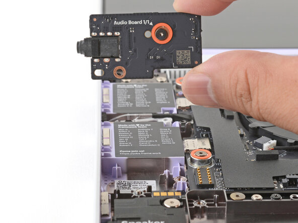

  10. Framework Laptop 12 Speakers Replacement, Remove the Audio Board: 10 단계, 이미지 1개 중 1개
    • Use your Framework Screwdriver to loosen the captive T5 Torx screw securing the Audio Board, located near the left edge of the laptop.
  11. Framework Laptop 12 Speakers Replacement: 11 단계, 이미지 3개 중 1개 Framework Laptop 12 Speakers Replacement: 11 단계, 이미지 3개 중 2개 Framework Laptop 12 Speakers Replacement: 11 단계, 이미지 3개 중 3개
    • Use your fingers to lift the right edge of the Audio Board and pull it out of its recess.
    • Remove the Audio Board.

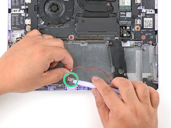

  14. Framework Laptop 12 Speakers Replacement, Unthread the speaker wire: 14 단계, 이미지 3개 중 1개 Framework Laptop 12 Speakers Replacement, Unthread the speaker wire: 14 단계, 이미지 3개 중 2개 Framework Laptop 12 Speakers Replacement, Unthread the speaker wire: 14 단계, 이미지 3개 중 3개
    • Use your Framework Screwdriver to lift and guide the wire connecting the two speakers out of the frame channel.
    • Use your Framework Screwdriver to lift the silver tape securing the center of the speaker wire to the frame.
    • If you're reusing the speakers, try to keep the silver tape intact.

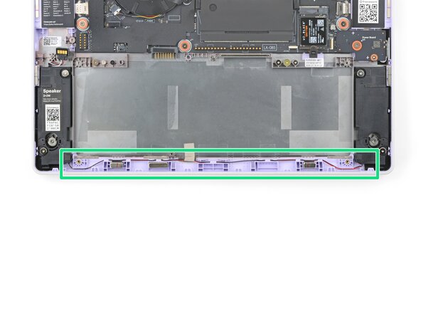

  17. Framework Laptop 12 Speakers Replacement, Install the speakers: 17 단계, 이미지 3개 중 1개 Framework Laptop 12 Speakers Replacement, Install the speakers: 17 단계, 이미지 3개 중 2개 Framework Laptop 12 Speakers Replacement, Install the speakers: 17 단계, 이미지 3개 중 3개
    • Use your Framework Screwdriver to loosely screw the left speaker in place.
    • Starting near the left speaker, use your fingers and your Framework Screwdriver to carefully press and guide the speaker wire back into its channel.
    • Zoom in on the second image to see how the wire sits in its channel.
    • Press the silver tape to adhere the center of the wire to the frame.
