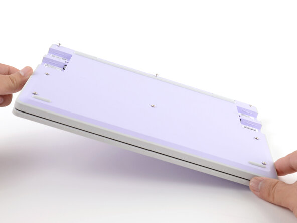

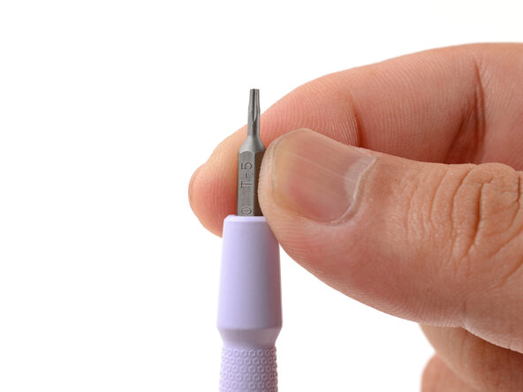

    • Before you begin repairs, unplug your laptop and shut it down from the operating system. This ensures that the laptop isn't in standby/suspend mode.
    • The indicator LEDs along the edges should be unlit. The laptop should be silent.
    • If you accidentally turn on the laptop during repair, hold the power button down for 10 seconds to shut it down.
    • Make sure your Framework Screwdriver has the T5 Torx bit (labeled as T-5) facing outwards. If it's not, pull the bit out and flip it.
  2. Framework Laptop 12 Webcam Cable Replacement, Set your laptop down: 2 단계, 이미지 1개 중 1개
    • Set your Framework Laptop face-down on a clean work surface.

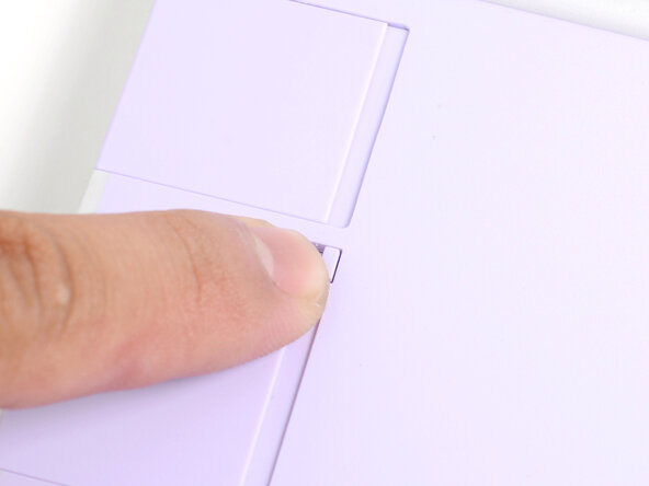

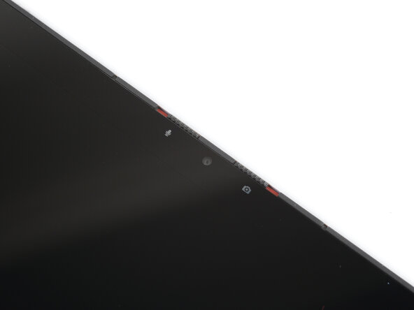

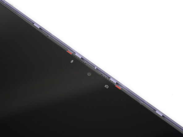

  3. Framework Laptop 12 Webcam Cable Replacement, Remove the Expansion Cards: 3 단계, 이미지 2개 중 1개 Framework Laptop 12 Webcam Cable Replacement, Remove the Expansion Cards: 3 단계, 이미지 2개 중 2개
    • Use your fingers to flip the two Expansion Card latches (one for each side) into the unlocked position.
    • The latches display a red bar when they're unlocked.

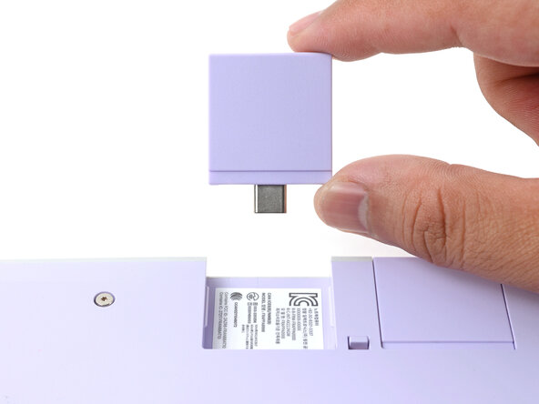

  4. Framework Laptop 12 Webcam Cable Replacement: 4 단계, 이미지 3개 중 1개 Framework Laptop 12 Webcam Cable Replacement: 4 단계, 이미지 3개 중 2개 Framework Laptop 12 Webcam Cable Replacement: 4 단계, 이미지 3개 중 3개
    • Grip the lip of an Expansion Card with your fingers.
    • Pull the Expansion Card out of its slot and remove it.
    • If you have trouble pulling the Expansion Card out, you can also use the flat end of your Framework Screwdriver to push against the lip.
    • Repeat this procedure to remove all remaining Expansion Cards.

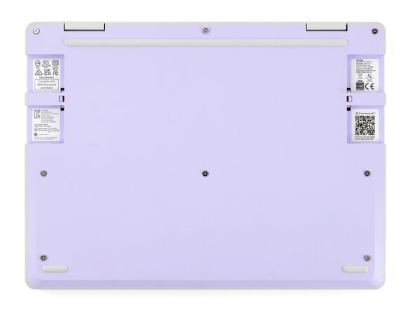

  5. Framework Laptop 12 Webcam Cable Replacement, Loosen the bottom screws: 5 단계, 이미지 2개 중 1개 Framework Laptop 12 Webcam Cable Replacement, Loosen the bottom screws: 5 단계, 이미지 2개 중 2개
    • Use your Framework Screwdriver to fully loosen the eight captive T5 Torx screws on the bottom of your laptop.
    • Most screws in your Framework Laptop (including these) are captive—they're designed to stay in place after you loosen them.
    • Your laptop comes with a spare set of screws in the frame above the battery. Be careful—the replacement screws aren't captive.

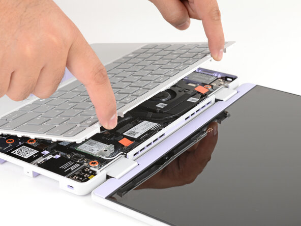

  7. Framework Laptop 12 Webcam Cable Replacement, Open your laptop: 7 단계, 이미지 2개 중 1개 Framework Laptop 12 Webcam Cable Replacement, Open your laptop: 7 단계, 이미지 2개 중 2개
    • Open the laptop lid so that both the screen and the base lie flat on your work surface.

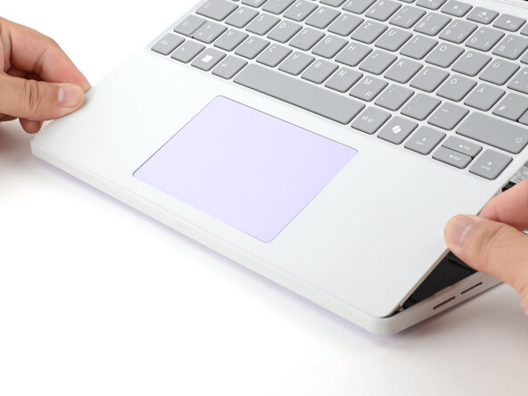

  8. Framework Laptop 12 Webcam Cable Replacement, Remove the Input Cover: 8 단계, 이미지 3개 중 1개 Framework Laptop 12 Webcam Cable Replacement, Remove the Input Cover: 8 단계, 이미지 3개 중 2개 Framework Laptop 12 Webcam Cable Replacement, Remove the Input Cover: 8 단계, 이미지 3개 중 3개
    • Use your fingers to grip the Input Cover in the hinge cutouts.
    • Lift upwards to swing the Input Cover up from the base of the laptop.
    • You may feel resistance from the magnets. If the cover feels like it's snagged, check that you've fully loosened the screws on the bottom of your laptop.
    • Remove the Input Cover.

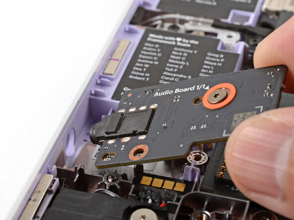

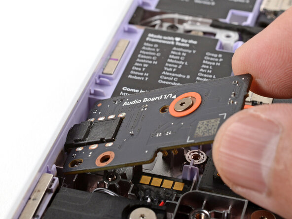

  12. Framework Laptop 12 Webcam Cable Replacement, Loosen the Audio Board screw: 12 단계, 이미지 1개 중 1개
    • Use your Framework Screwdriver to loosen the captive T5 Torx screw securing the Audio Board along the left edge of the laptop.
  13. Framework Laptop 12 Webcam Cable Replacement, Remove the Audio Board: 13 단계, 이미지 3개 중 1개 Framework Laptop 12 Webcam Cable Replacement, Remove the Audio Board: 13 단계, 이미지 3개 중 2개 Framework Laptop 12 Webcam Cable Replacement, Remove the Audio Board: 13 단계, 이미지 3개 중 3개
    • Use your fingers to lift the right edge of the Audio Board and pull it out of its recess.
    • Remove the Audio Board.

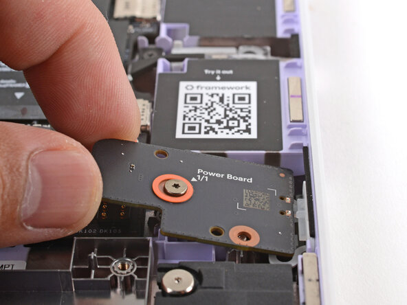

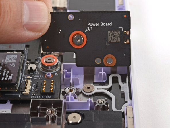

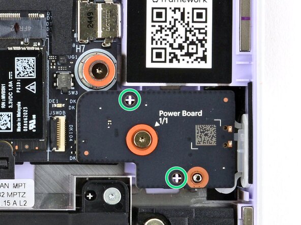

  14. Framework Laptop 12 Webcam Cable Replacement, Loosen the Power Button Board screw: 14 단계, 이미지 1개 중 1개
    • Use your Framework Screwdriver to loosen the captive T5 Torx screw securing the Power Button Board (labeled "Power Board").
  15. Framework Laptop 12 Webcam Cable Replacement, Remove the Power Button Board: 15 단계, 이미지 2개 중 1개 Framework Laptop 12 Webcam Cable Replacement, Remove the Power Button Board: 15 단계, 이미지 2개 중 2개
    • Use your fingers to lift and remove the Power Button Board.

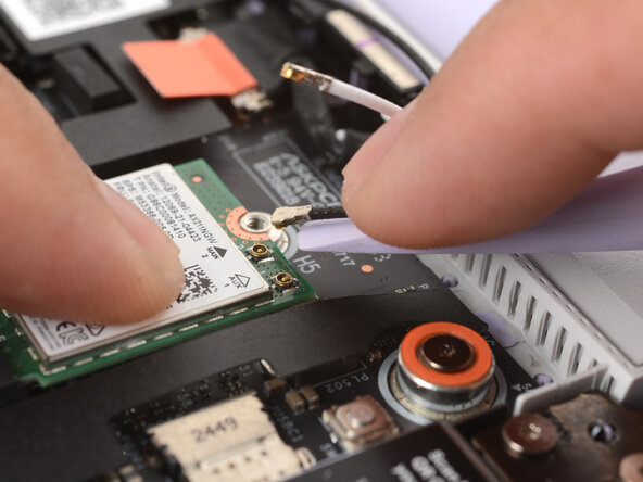

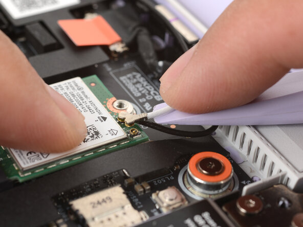

  18. Framework Laptop 12 Webcam Cable Replacement, Disconnect the antenna cables: 18 단계, 이미지 3개 중 1개 Framework Laptop 12 Webcam Cable Replacement, Disconnect the antenna cables: 18 단계, 이미지 3개 중 2개 Framework Laptop 12 Webcam Cable Replacement, Disconnect the antenna cables: 18 단계, 이미지 3개 중 3개
    • The Wi-Fi card has two delicate coaxial cable connectors. Follow this step carefully to avoid damaging them.
    • Press and hold the Wi-Fi card down with your finger.
    • Slide the flat edge of your Framework Screwdriver under the white antenna cable, as close to the metal head as possible.
    • If you have angled tweezers, slide one arm of a pair of tweezers under the antenna connector, as close to the metal head as possible.
    • Gently lift the connector straight up to disconnect the white antenna cable.
    • Repeat the procedure with the black antenna cable.

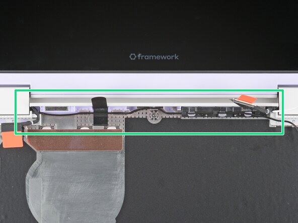

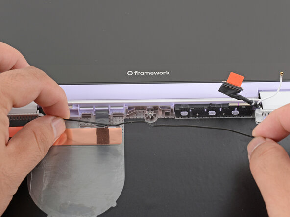

  24. Framework Laptop 12 Webcam Cable Replacement, Unthread the antenna cable: 24 단계, 이미지 2개 중 1개 Framework Laptop 12 Webcam Cable Replacement, Unthread the antenna cable: 24 단계, 이미지 2개 중 2개
    • Use your fingers to lift the black plastic loop securing the antenna cable, near the heat vents by the left hinge.
  25. Framework Laptop 12 Webcam Cable Replacement: 25 단계, 이미지 2개 중 1개 Framework Laptop 12 Webcam Cable Replacement: 25 단계, 이미지 2개 중 2개
    • Use your fingers to lift and guide the antenna cable out of the frame channel.
  26. Framework Laptop 12 Webcam Cable Replacement, Unthread the webcam cable: 26 단계, 이미지 2개 중 1개 Framework Laptop 12 Webcam Cable Replacement, Unthread the webcam cable: 26 단계, 이미지 2개 중 2개
    • Use your fingers to gently lift the webcam cable out of its plastic channel.

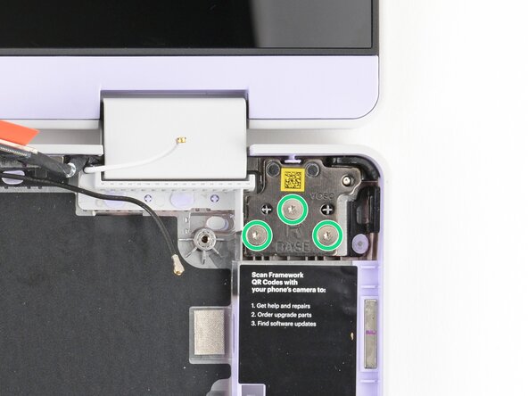

  27. Framework Laptop 12 Webcam Cable Replacement, Disconnect the Top Cover: 27 단계, 이미지 2개 중 1개 Framework Laptop 12 Webcam Cable Replacement, Disconnect the Top Cover: 27 단계, 이미지 2개 중 2개
    • Use your Framework Screwdriver to remove the six (three per hinge) 4.5 mm‑long T5 Torx screws securing the two hinges.
    • These screws are not captive. Store them in a safe location for reassembly.

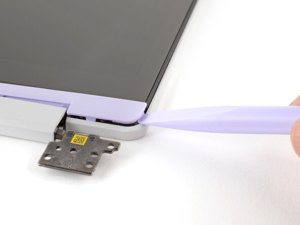

  29. Framework Laptop 12 Webcam Cable Replacement, Remove the Display Cover: 29 단계, 이미지 2개 중 1개 Framework Laptop 12 Webcam Cable Replacement, Remove the Display Cover: 29 단계, 이미지 2개 중 2개
    • The Display Cover is held in place with magnets along its top edge and clips along its remaining edges.
    • Use the flat end of your Framework Screwdriver to pry up the right edge of the Display Cover.
  30. Framework Laptop 12 Webcam Cable Replacement: 30 단계, 이미지 2개 중 1개 Framework Laptop 12 Webcam Cable Replacement: 30 단계, 이미지 2개 중 2개
    • Slide your fingers under the top edge of the Display Cover to release it from the laptop.
  31. Framework Laptop 12 Webcam Cable Replacement: 31 단계, 이미지 1개 중 1개
    • Remove the Display Cover.

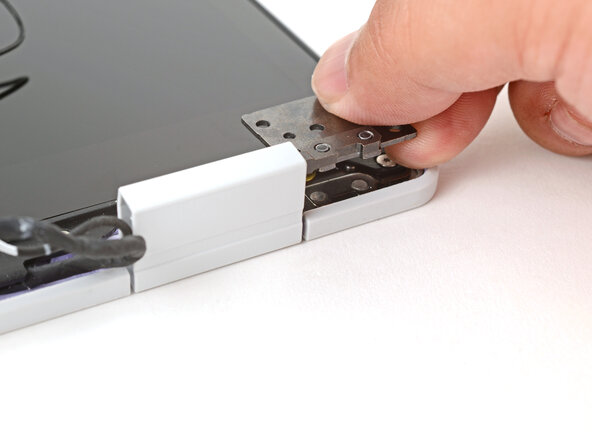

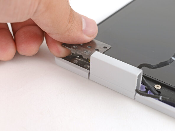

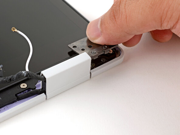

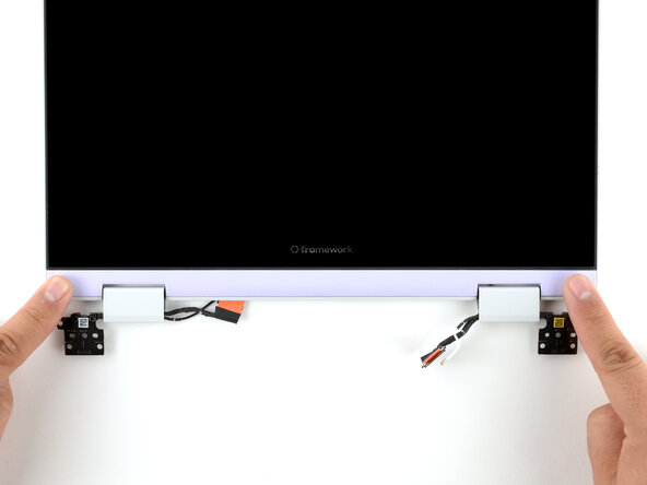

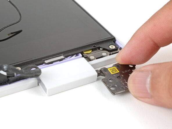

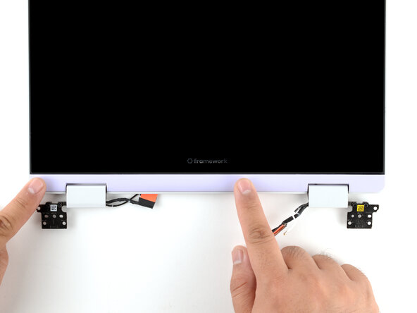

  32. Framework Laptop 12 Webcam Cable Replacement, Bend the hinges up: 32 단계, 이미지 3개 중 1개 Framework Laptop 12 Webcam Cable Replacement, Bend the hinges up: 32 단계, 이미지 3개 중 2개 Framework Laptop 12 Webcam Cable Replacement, Bend the hinges up: 32 단계, 이미지 3개 중 3개
    • Use your fingers to twist the right hinge plate until it's flipped on top of the display.
    • The stiff hinge can be difficult to twist. Wear some work gloves, or use a cloth to help get a better grip.
  33. Framework Laptop 12 Webcam Cable Replacement: 33 단계, 이미지 3개 중 1개 Framework Laptop 12 Webcam Cable Replacement: 33 단계, 이미지 3개 중 2개 Framework Laptop 12 Webcam Cable Replacement: 33 단계, 이미지 3개 중 3개
    • Twist the left hinge plate until it's flipped on top of the display.

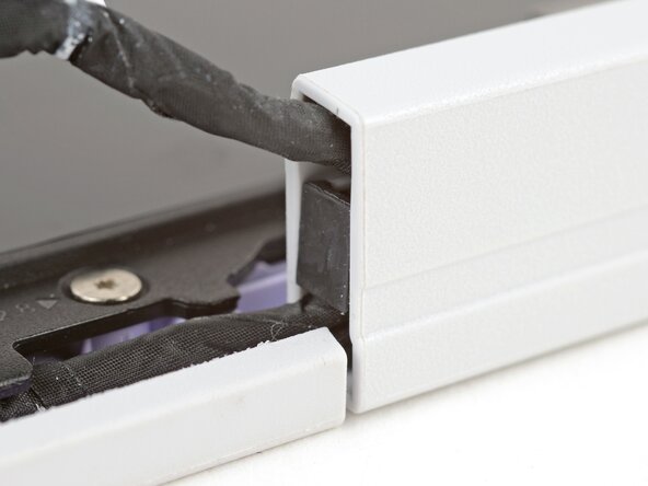

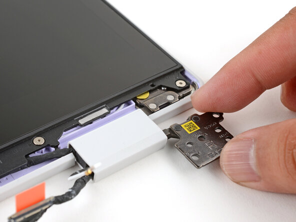

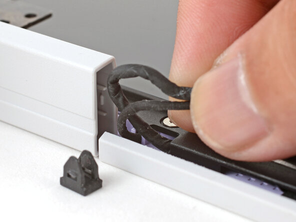

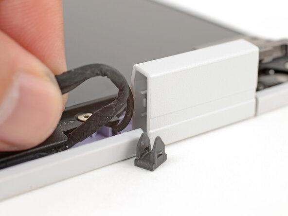

  34. Framework Laptop 12 Webcam Cable Replacement, Release the cables from the hinges: 34 단계, 이미지 2개 중 1개 Framework Laptop 12 Webcam Cable Replacement, Release the cables from the hinges: 34 단계, 이미지 2개 중 2개
    • Use your fingers to grab the two cables coming out of the left hinge.
    • Pull gently to pop out the black cable clip and release the cables.
    • Store the cable clip for reassembly.

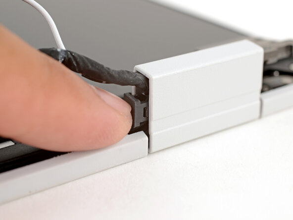

  35. Framework Laptop 12 Webcam Cable Replacement: 35 단계, 이미지 2개 중 1개 Framework Laptop 12 Webcam Cable Replacement: 35 단계, 이미지 2개 중 2개
    • Repeat the procedure on the right hinge to release the cables.
  36. Framework Laptop 12 Webcam Cable Replacement, Twist the hinge plates down: 36 단계, 이미지 3개 중 1개 Framework Laptop 12 Webcam Cable Replacement, Twist the hinge plates down: 36 단계, 이미지 3개 중 2개 Framework Laptop 12 Webcam Cable Replacement, Twist the hinge plates down: 36 단계, 이미지 3개 중 3개
    • Use your fingers to twist both hinge plates back down so they lay flat on your work surface.

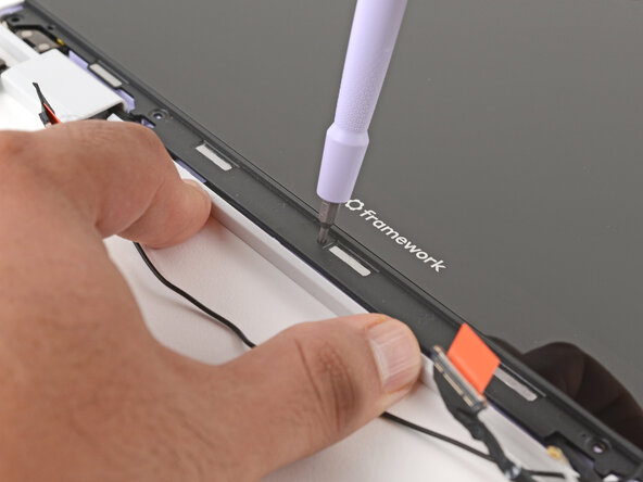

  38. Framework Laptop 12 Webcam Cable Replacement, Slide the display down: 38 단계, 이미지 2개 중 1개 Framework Laptop 12 Webcam Cable Replacement, Slide the display down: 38 단계, 이미지 2개 중 2개
    • Use your fingers to hold the bottom edge of the Top Cover in place.
    • Insert the bit end of your Framework Screwdriver into the small hole on the display, below the Framework logo.
    • Slide the display down towards the hinge edge to release the tabs holding the top edge of the display in place.

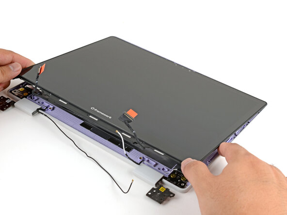

  39. Framework Laptop 12 Webcam Cable Replacement, Lift the display: 39 단계, 이미지 2개 중 1개 Framework Laptop 12 Webcam Cable Replacement, Lift the display: 39 단계, 이미지 2개 중 2개
    • Use your fingers to lift the top edge of the display from the Top Cover.
  40. Framework Laptop 12 Webcam Cable Replacement, Remove the display: 40 단계, 이미지 2개 중 1개 Framework Laptop 12 Webcam Cable Replacement, Remove the display: 40 단계, 이미지 2개 중 2개
    • Lift and remove the display from the Top Cover.

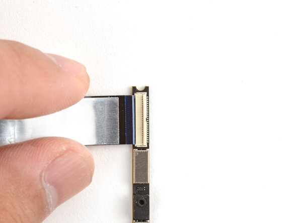

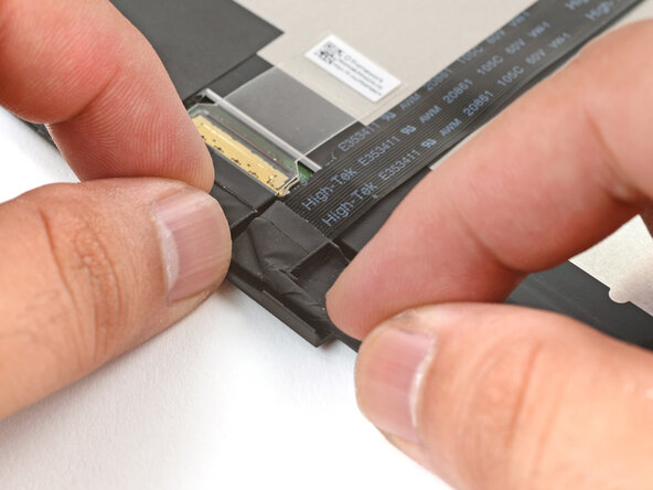

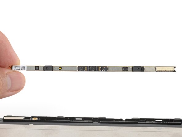

  43. Framework Laptop 12 Webcam Cable Replacement, Disconnect the webcam: 43 단계, 이미지 3개 중 1개 Framework Laptop 12 Webcam Cable Replacement, Disconnect the webcam: 43 단계, 이미지 3개 중 2개 Framework Laptop 12 Webcam Cable Replacement, Disconnect the webcam: 43 단계, 이미지 3개 중 3개
    • Use the flat end of your Framework Screwdriver to lift the webcam out of its recess.
    • Avoid touching the black camera module near the center of the webcam.
    • Flip the webcam over and gently hold it down with your fingers.

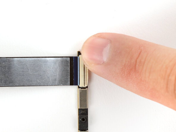

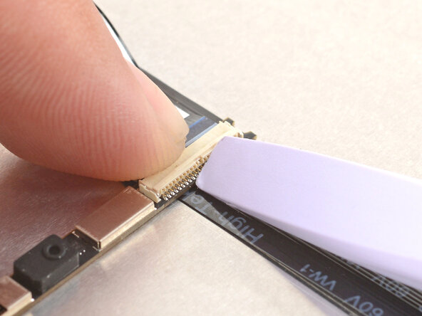

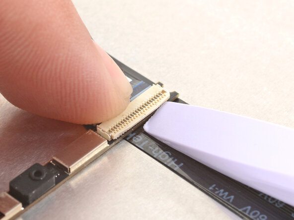

  44. Framework Laptop 12 Webcam Cable Replacement: 44 단계, 이미지 3개 중 1개 Framework Laptop 12 Webcam Cable Replacement: 44 단계, 이미지 3개 중 2개 Framework Laptop 12 Webcam Cable Replacement: 44 단계, 이미지 3개 중 3개
    • Use the flat end of your Framework Screwdriver or a fingernail to gently pry up the locking tab on the webcam cable ZIF connector.
  45. Framework Laptop 12 Webcam Cable Replacement, Remove the webcam: 45 단계, 이미지 3개 중 1개 Framework Laptop 12 Webcam Cable Replacement, Remove the webcam: 45 단계, 이미지 3개 중 2개 Framework Laptop 12 Webcam Cable Replacement, Remove the webcam: 45 단계, 이미지 3개 중 3개
    • Slide the webcam cable out of its connector.
    • Remove the webcam.

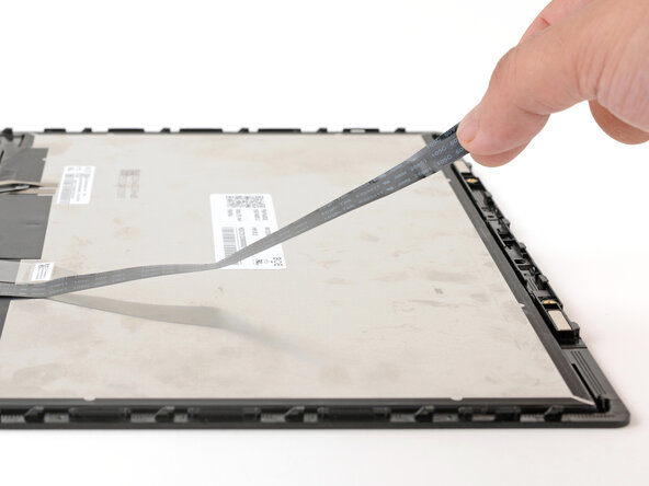

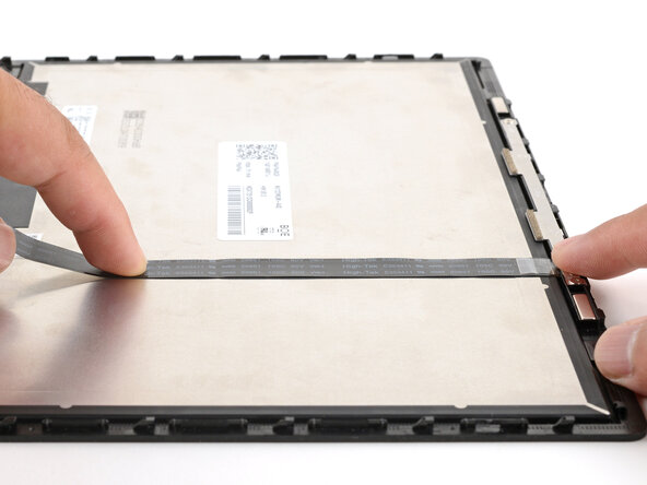

  46. Framework Laptop 12 Webcam Cable Replacement, Detach the webcam cable: 46 단계, 이미지 2개 중 1개 Framework Laptop 12 Webcam Cable Replacement, Detach the webcam cable: 46 단계, 이미지 2개 중 2개
    • The webcam cable is lightly adhered to the display.
    • Grab the webcam cable with your fingers and slowly peel it away from the display.

  49. Framework Laptop 12 Webcam Cable Replacement, Attach the replacement webcam cable: 49 단계, 이미지 3개 중 1개 Framework Laptop 12 Webcam Cable Replacement, Attach the replacement webcam cable: 49 단계, 이미지 3개 중 2개 Framework Laptop 12 Webcam Cable Replacement, Attach the replacement webcam cable: 49 단계, 이미지 3개 중 3개
    • To properly align the replacement webcam cable, you'll install the cable onto the webcam first, install the webcam, then attach the cable onto the display.
    • Hold the webcam cable with the shiny side facing up.
    • Slide the cable into the webcam module's ZIF connector, up to the printed line on the cable.
    • Use your finger to flip down and gently press the locking tab in place.
  50. Framework Laptop 12 Webcam Cable Replacement: 50 단계, 이미지 2개 중 1개 Framework Laptop 12 Webcam Cable Replacement: 50 단계, 이미지 2개 중 2개
    • Insert the webcam back into its display recess.

  53. Framework Laptop 12 Webcam Cable Replacement: 53 단계, 이미지 3개 중 1개 Framework Laptop 12 Webcam Cable Replacement: 53 단계, 이미지 3개 중 2개 Framework Laptop 12 Webcam Cable Replacement: 53 단계, 이미지 3개 중 3개
    • If the webcam cable has any plastic liners covering adhesives, peel them off to expose the adhesives. These liners should peel easily from the cable.
    • Use your fingers to press the cable onto the display.
    • Guide the cable bend into its channel on the display.
  54. Framework Laptop 12 Webcam Cable Replacement, Install the display: 54 단계, 이미지 3개 중 1개 Framework Laptop 12 Webcam Cable Replacement, Install the display: 54 단계, 이미지 3개 중 2개 Framework Laptop 12 Webcam Cable Replacement, Install the display: 54 단계, 이미지 3개 중 3개
    • Lay the display in place in the Top Cover, such that the top edge of the display is slightly below the top edge of the Top Cover.
  55. Framework Laptop 12 Webcam Cable Replacement: 55 단계, 이미지 3개 중 1개 Framework Laptop 12 Webcam Cable Replacement: 55 단계, 이미지 3개 중 2개 Framework Laptop 12 Webcam Cable Replacement: 55 단계, 이미지 3개 중 3개
    • Use your fingers to slide the display upwards to latch the tabs on the top edge of the display.
    • The top edge shouldn't have any gaps when the display's in place.
  56. Framework Laptop 12 Webcam Cable Replacement, Install the display screws: 56 단계, 이미지 1개 중 1개
    • Use your Framework Screwdriver to install the four 3.3 mm‑long T5 Torx screws to secure the display to the Top Cover.
    • Make sure you don't accidentally install the 4.5 mm‑long hinge screws here. They look identical, but the hinge screws are longer.
    • Tighten the screws until they're snug. Don't over-tighten them, or you may damage the screw tabs.

    • Use your fingers to twist both hinge plates so they're flipped over the display.
  58. Framework Laptop 12 Webcam Cable Replacement: 58 단계, 이미지 3개 중 1개 Framework Laptop 12 Webcam Cable Replacement: 58 단계, 이미지 3개 중 2개 Framework Laptop 12 Webcam Cable Replacement: 58 단계, 이미지 3개 중 3개
    • Place the cable clip around the right hinge cables, where they were bent from being inserted into the hinge.
    • Use your fingers to press the clip into the hinge to secure the cables.
  59. Framework Laptop 12 Webcam Cable Replacement: 59 단계, 이미지 2개 중 1개 Framework Laptop 12 Webcam Cable Replacement: 59 단계, 이미지 2개 중 2개
    • Repeat the procedure on the left hinge to secure the left cables.
  60. Framework Laptop 12 Webcam Cable Replacement: 60 단계, 이미지 2개 중 1개 Framework Laptop 12 Webcam Cable Replacement: 60 단계, 이미지 2개 중 2개
    • Make sure both cable clips are fully inserted into the hinges, so that they won't be snagged when the hinges pivot.
  61. Framework Laptop 12 Webcam Cable Replacement: 61 단계, 이미지 3개 중 1개 Framework Laptop 12 Webcam Cable Replacement: 61 단계, 이미지 3개 중 2개 Framework Laptop 12 Webcam Cable Replacement: 61 단계, 이미지 3개 중 3개
    • Use your fingers to twist both hinge plates so that they lay flat on your work surface.

    • Use your fingers to gently press the webcam cable into its plastic channel.
  66. Framework Laptop 12 Webcam Cable Replacement: 66 단계, 이미지 2개 중 1개 Framework Laptop 12 Webcam Cable Replacement: 66 단계, 이미지 2개 중 2개
    • Use your fingers and your Framework Screwdriver to carefully press and guide the black antenna cable back into its channel.
    • Zoom in on the second image to see how the antenna cable sits in its channel.
  67. Framework Laptop 12 Webcam Cable Replacement: 67 단계, 이미지 2개 중 1개 Framework Laptop 12 Webcam Cable Replacement: 67 단계, 이미지 2개 중 2개
    • Press the black loop over the antenna cable and onto the Bottom Cover. If it doesn't stick, use a bit of thin double-sided tape to hold it down.

  73. Framework Laptop 12 Webcam Cable Replacement: 73 단계, 이미지 3개 중 1개 Framework Laptop 12 Webcam Cable Replacement: 73 단계, 이미지 3개 중 2개 Framework Laptop 12 Webcam Cable Replacement: 73 단계, 이미지 3개 중 3개
    • Hold the Wi-Fi card down with your finger.
    • Position the black antenna cable connector over the left Wi-Fi card's coaxial socket.
    • Tweezers can help position the connector.
    • Use your finger to press the connector into place. You should feel a faint click, and the cable will stay attached to the socket by itself.
    • These connectors are very delicate! If the connector doesn't feel like it's clicking in place, reposition the connector and try again.
    • Repeat the procedure with the white antenna cable.

  76. Framework Laptop 12 Webcam Cable Replacement, Install the Power Button Board: 76 단계, 이미지 3개 중 1개 Framework Laptop 12 Webcam Cable Replacement, Install the Power Button Board: 76 단계, 이미지 3개 중 2개 Framework Laptop 12 Webcam Cable Replacement, Install the Power Button Board: 76 단계, 이미지 3개 중 3개
    • Use your fingers to lay the Power Button Board in place.
    • Use the two plastic pins on the laptop to align the Power Button Board.
  77. Framework Laptop 12 Webcam Cable Replacement: 77 단계, 이미지 1개 중 1개
    • Use your Framework Screwdriver to tighten the captive T5 Torx screw to secure the Power Button Board.
    • Tighten the screw until it's snug. Don't over-tighten it, or you may strip the screw.
  78. Framework Laptop 12 Webcam Cable Replacement, Install the Audio Board: 78 단계, 이미지 3개 중 1개 Framework Laptop 12 Webcam Cable Replacement, Install the Audio Board: 78 단계, 이미지 3개 중 2개 Framework Laptop 12 Webcam Cable Replacement, Install the Audio Board: 78 단계, 이미지 3개 중 3개
    • Insert the Audio Board into the laptop at an angle to help align the headphone jack.
    • Use the two plastic alignment pins on the laptop to help with final alignment.
  79. Framework Laptop 12 Webcam Cable Replacement: 79 단계, 이미지 1개 중 1개
    • Use your Framework Screwdriver to tighten the captive T5 Torx screw to secure the Audio Board.

  83. Framework Laptop 12 Webcam Cable Replacement, Install the Input Cover: 83 단계, 이미지 3개 중 1개 Framework Laptop 12 Webcam Cable Replacement, Install the Input Cover: 83 단계, 이미지 3개 중 2개 Framework Laptop 12 Webcam Cable Replacement, Install the Input Cover: 83 단계, 이미지 3개 중 3개
    • Angle the bottom edge of the Input Cover towards the base of the laptop.
    • Align and insert the bottom edge of the Input Cover into the base of the laptop.
    • Make sure the slots along the bottom edge of the Input Cover slide into the tabs in the base.
    • Lower the Input Cover's top edge onto the laptop until the magnets snap it in place.
    • Make sure the Input Cover sits neatly within the laptop frame and no corners are popping up.

  86. Framework Laptop 12 Webcam Cable Replacement, Install the Expansion Cards: 86 단계, 이미지 3개 중 1개 Framework Laptop 12 Webcam Cable Replacement, Install the Expansion Cards: 86 단계, 이미지 3개 중 2개 Framework Laptop 12 Webcam Cable Replacement, Install the Expansion Cards: 86 단계, 이미지 3개 중 3개
    • Slide each Expansion Card into its Expansion Card slot.
  87. Framework Laptop 12 Webcam Cable Replacement, Lock the Expansion Card slots: 87 단계, 이미지 2개 중 1개 Framework Laptop 12 Webcam Cable Replacement, Lock the Expansion Card slots: 87 단계, 이미지 2개 중 2개
    • If there's a red bar showing under either Expansion Card latch, use your finger to flip the latch and lock the Expansion Card into its slot.
    • Locking the Expansion Card slots helps keep the cards in place when you unplug cables from them.
