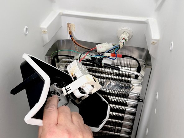

  17. Frigidaire Side-By-Side Refrigerator Evaporator Fan Replacement, Reposition evaporator fan assembly: 17 단계, 이미지 2개 중 1개 Frigidaire Side-By-Side Refrigerator Evaporator Fan Replacement, Reposition evaporator fan assembly: 17 단계, 이미지 2개 중 2개
    • Lift the evaporator fan assembly up from where it is located on the rear of the freezer compartment.
    • Turn the evaporator fan assembly over to the underside to more readily access the electrical connections.

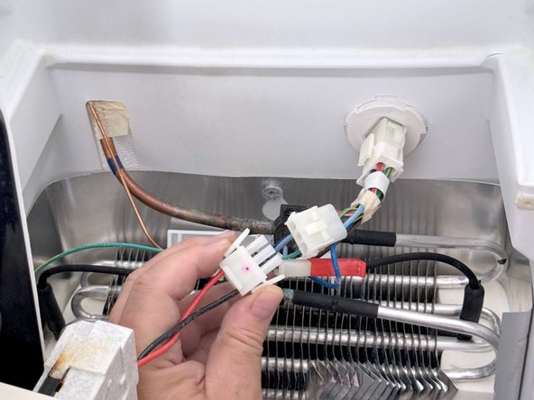

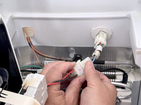

  18. Frigidaire Side-By-Side Refrigerator Evaporator Fan Replacement, Disconnect evaporator fan: 18 단계, 이미지 3개 중 1개 Frigidaire Side-By-Side Refrigerator Evaporator Fan Replacement, Disconnect evaporator fan: 18 단계, 이미지 3개 중 2개 Frigidaire Side-By-Side Refrigerator Evaporator Fan Replacement, Disconnect evaporator fan: 18 단계, 이미지 3개 중 3개
    • Grasp the evaporator fan connector and squeeze the release tabs located on each side of the connector.
    • Separate the connector by pulling it apart. You may need both hands to do this, one on each half of the connector.

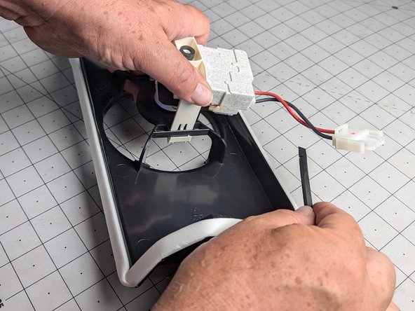

  22. Frigidaire Side-By-Side Refrigerator Evaporator Fan Replacement, Remove the fan motor bracket: 22 단계, 이미지 3개 중 1개 Frigidaire Side-By-Side Refrigerator Evaporator Fan Replacement, Remove the fan motor bracket: 22 단계, 이미지 3개 중 2개 Frigidaire Side-By-Side Refrigerator Evaporator Fan Replacement, Remove the fan motor bracket: 22 단계, 이미지 3개 중 3개
    • Press the bottom of the bracket inward to release the hook.
    • While pressing inward, pull the hook upward to free the motor bracket.
    • Repeat the last three steps for the other side of the fan motor bracket.

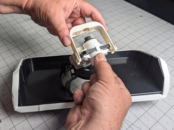

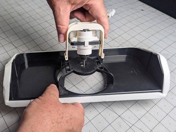

  23. Frigidaire Side-By-Side Refrigerator Evaporator Fan Replacement, Remove motor and motor bracket from evaporator fan assembly: 23 단계, 이미지 3개 중 1개 Frigidaire Side-By-Side Refrigerator Evaporator Fan Replacement, Remove motor and motor bracket from evaporator fan assembly: 23 단계, 이미지 3개 중 2개 Frigidaire Side-By-Side Refrigerator Evaporator Fan Replacement, Remove motor and motor bracket from evaporator fan assembly: 23 단계, 이미지 3개 중 3개
    • Lift motor bracket and motor from evaporator fan assembly.

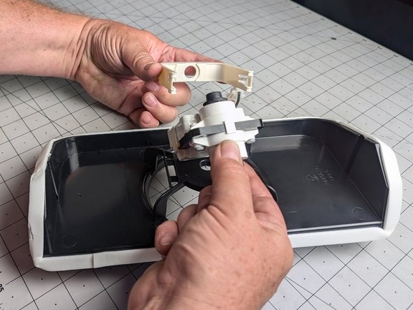

  24. Frigidaire Side-By-Side Refrigerator Evaporator Fan Replacement, Remove motor from motor bracket: 24 단계, 이미지 3개 중 1개 Frigidaire Side-By-Side Refrigerator Evaporator Fan Replacement, Remove motor from motor bracket: 24 단계, 이미지 3개 중 2개 Frigidaire Side-By-Side Refrigerator Evaporator Fan Replacement, Remove motor from motor bracket: 24 단계, 이미지 3개 중 3개
    • Pull the motor bracket upward to separate the motor from the motor bracket.
  25. Frigidaire Side-By-Side Refrigerator Evaporator Fan Replacement, Fan motor is ready for replacement: 25 단계, 이미지 2개 중 1개 Frigidaire Side-By-Side Refrigerator Evaporator Fan Replacement, Fan motor is ready for replacement: 25 단계, 이미지 2개 중 2개
    • Fan motor can now be replaced.
    • Keep track of the rubber mounting bushings on both faces of the motor as the replacement motor may not come with them.
