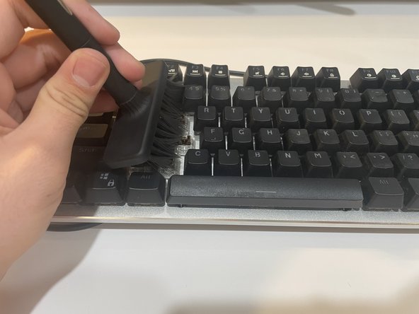

  3. GAMDIAS Hermes E1C Keyboard Switch Replacement: 3 단계, 이미지 3개 중 1개 GAMDIAS Hermes E1C Keyboard Switch Replacement: 3 단계, 이미지 3개 중 2개 GAMDIAS Hermes E1C Keyboard Switch Replacement: 3 단계, 이미지 3개 중 3개
    • Use a brush to remove any debris to prevent any connection issues for the switches.
    • You will need to spend a bit of time moving the brush up and down through the switches as some debris may not be cleared.
    • Usage of the brush shown in the 3rd picture is only needed if there are clear signs of debris stuck under the switch.

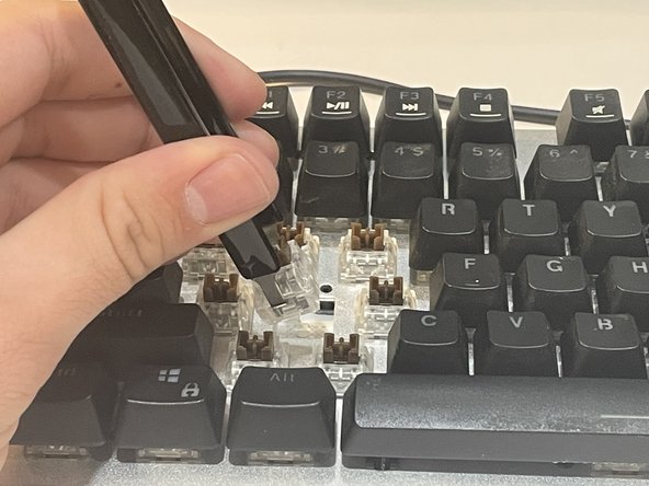

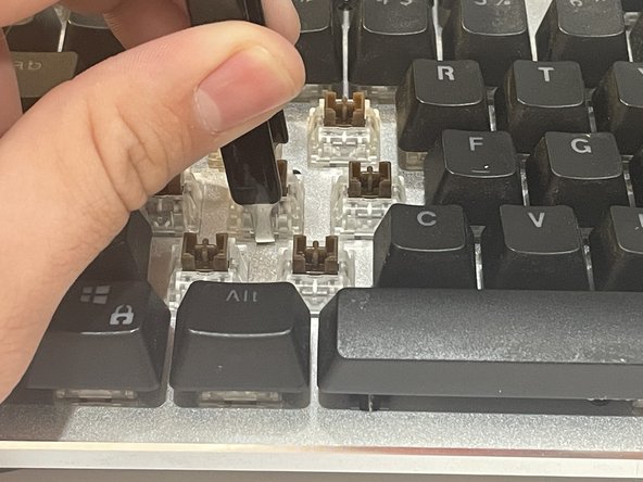

  4. GAMDIAS Hermes E1C Keyboard Switch Replacement: 4 단계, 이미지 3개 중 1개 GAMDIAS Hermes E1C Keyboard Switch Replacement: 4 단계, 이미지 3개 중 2개 GAMDIAS Hermes E1C Keyboard Switch Replacement: 4 단계, 이미지 3개 중 3개
    • Using a switch puller, you want to target the top and bottom of the switch.
    • When you feel like the tool is safely under the switch you can simply pull it upwards with a bit of force.

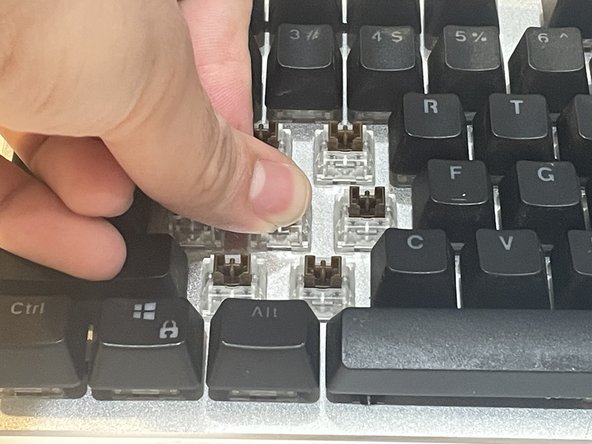

  5. GAMDIAS Hermes E1C Keyboard Switch Replacement: 5 단계, 이미지 3개 중 1개 GAMDIAS Hermes E1C Keyboard Switch Replacement: 5 단계, 이미지 3개 중 2개 GAMDIAS Hermes E1C Keyboard Switch Replacement: 5 단계, 이미지 3개 중 3개
    • Before inserting the new/working switch, you need to make sure that you can either:
    • See an X symbol facing towards you.
    • See that the top of the brown switch is horizontal like a rectangle.
    • Insert the correctly aligned switch by using a bit of force to push in the switch as there are no pins to be mindful of.
    • If the switch is not correctly aligned you run the risk of damaging the switch or even getting it stuck in the keyboard.
