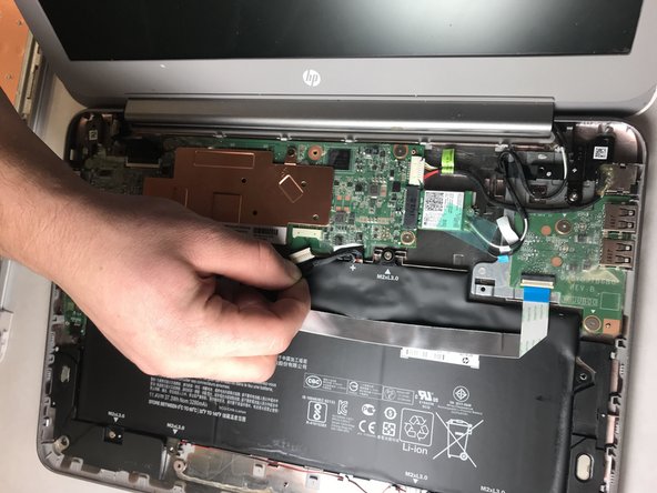

  4. HP Chromebook 14-ak013dx  WiFi Card Replacement: 4 단계, 이미지 3개 중 1개 HP Chromebook 14-ak013dx  WiFi Card Replacement: 4 단계, 이미지 3개 중 2개 HP Chromebook 14-ak013dx  WiFi Card Replacement: 4 단계, 이미지 3개 중 3개
    • Disconnect the battery cable shown in the first picture before moving on. This can be done with an opening tool if necessary.
