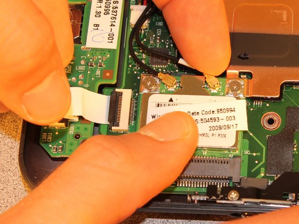

  12. HP Mini 110-1046NR Wireless Card Replacement, Wireless Card: 12 단계, 이미지 2개 중 1개 HP Mini 110-1046NR Wireless Card Replacement, Wireless Card: 12 단계, 이미지 2개 중 2개
    • Using a pry stick, pop off the two cables from the rearward edge of the card.
    • Be sure to make a note of which cable attaches to which connector on the card. The cable with the white band should connect to connector labelled "J2."
  13. HP Mini 110-1046NR Wireless Card Replacement: 13 단계, 이미지 3개 중 1개 HP Mini 110-1046NR Wireless Card Replacement: 13 단계, 이미지 3개 중 2개 HP Mini 110-1046NR Wireless Card Replacement: 13 단계, 이미지 3개 중 3개
    • Remove the two 3.4mm screws that hold down the rearward edge of the card with a Phillips PH0 screwdriver.
    • The card is spring loaded at the receptacle. Unless you hold it down, the card will spring up once both screws are removed.
    • Allow the card to lift up, and then slide it out of the black receptacle.
    • When putting the card back in, make sure it is fully seated in the receptacle before pushing it down to re-insert the screws.
