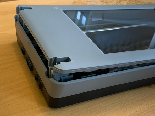

  4. HP Scanjet 4890 Scanner Glass Underside Cleaning, Turn back so that the scanner glass is up: 4 단계, 이미지 1개 중 1개
    • While the problem usually is to separate the top from the bottom, make sure that the top does not fall off while turning the scanner over, damaging the scanner glass.
  5. HP Scanjet 4890 Scanner Glass Underside Cleaning, Lift the top cover off the base: 5 단계, 이미지 3개 중 1개 HP Scanjet 4890 Scanner Glass Underside Cleaning, Lift the top cover off the base: 5 단계, 이미지 3개 중 2개 HP Scanjet 4890 Scanner Glass Underside Cleaning, Lift the top cover off the base: 5 단계, 이미지 3개 중 3개
    이 단계에 사용된 도구:
    Heavy-Duty Suction Cups (Pair)
    $14.95
    • The top has to be lifted straight up at the front and back at the same time.
    • I found Heavy-Duty Suction Cups (Pair) to work best, but due to the structure of the plastic they quickly loose their grip, so work fast.
    • Alternative: Lift the top cover in the back as little as possible and use Plastic Cards to work your way to the front until you are able to get a grip of the whole top cover and lift it straight up.
