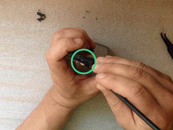

    • Disconnect one by one:
    • the Touchscreen flex cable
    • the Volume buttons & Mic flex cable
    • the Dock connector flex cable

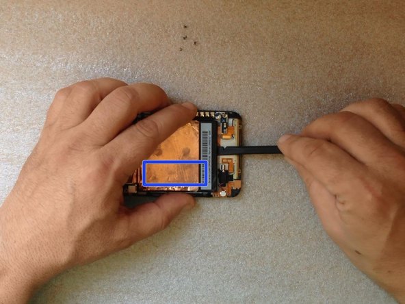

    • Carefully insert a plastic tool under the battery to pry it up from the adhesive. Avoid bending the battery.
    • Be careful, there are flex cables under the battery. At the last picture in this step you can see the cables and the place were is adhesive tape.
    • Now you can separate the Dock flex cable.
