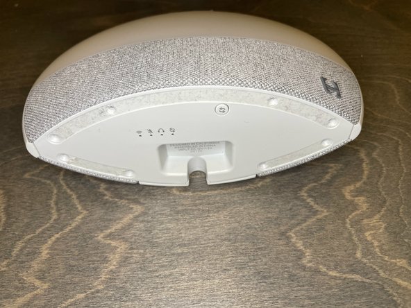

  2. Hatch Restore Bottom Circuit Board Replacement: 2 단계, 이미지 2개 중 1개 Hatch Restore Bottom Circuit Board Replacement: 2 단계, 이미지 2개 중 2개
    • Peel away the rubber feet.
  3. Hatch Restore Bottom Circuit Board Replacement: 3 단계, 이미지 2개 중 1개 Hatch Restore Bottom Circuit Board Replacement: 3 단계, 이미지 2개 중 2개
    • Remove the indicated 8 screws.
    • You may need to remove some adhesive from the screws to remove them.

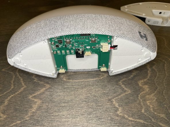

  4. Hatch Restore Bottom Circuit Board Replacement: 4 단계, 이미지 2개 중 1개 Hatch Restore Bottom Circuit Board Replacement: 4 단계, 이미지 2개 중 2개
    • Pry off the bottom cover.
  5. Hatch Restore Bottom Circuit Board Replacement: 5 단계, 이미지 1개 중 1개
    • Remove the 6 indicated screws.

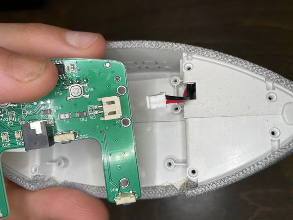

  6. Hatch Restore Bottom Circuit Board Replacement: 6 단계, 이미지 2개 중 1개 Hatch Restore Bottom Circuit Board Replacement: 6 단계, 이미지 2개 중 2개
    • Remove the power cable
    • There is a ribbon cable under the board. Do not pull the circuit board too far from the device.

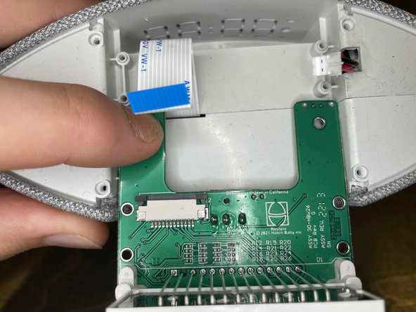

  7. Hatch Restore Bottom Circuit Board Replacement: 7 단계, 이미지 2개 중 1개 Hatch Restore Bottom Circuit Board Replacement: 7 단계, 이미지 2개 중 2개
    • Push the black tabs on the ZIF connector towards the cable, then remove the cable.
    • The cable should have no resistance when pulled out. Do not forcefully remove the cable.
