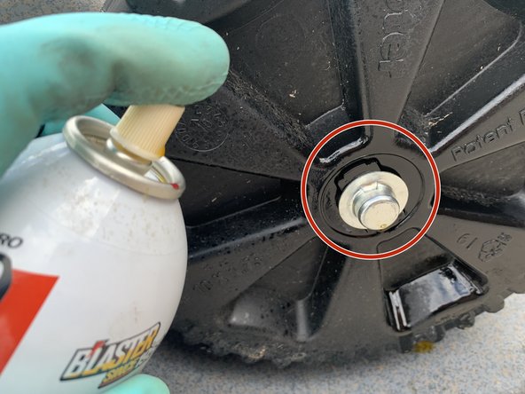

  3. How To Replace the Wheels on a Trash Can: 3 단계, 이미지 3개 중 1개 How To Replace the Wheels on a Trash Can: 3 단계, 이미지 3개 중 2개 How To Replace the Wheels on a Trash Can: 3 단계, 이미지 3개 중 3개
    • Use the rubber mallet to hit the back of the wheel and loosen the pal-nut.
    • If the pal-nut is stuck, use PB B'LASTER to spray on the pal-nut to break up any rust or corrosion.
    • Caution: Wear gloves so the PB B'LASTER does not get on your skin.
    • Remove the pal-nut.

Thien Pham -
The nut wont come off. I had to saw the axel in half.
Is Sira - 답글
