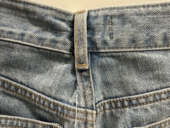

    • Put on the jeans and pinch the extra fabric at the centre back of the waistband.

    • Mark both sides of the pinched fabric with chalk on the outside of the jeans.
    • You may do this step while wearing the jeans.
