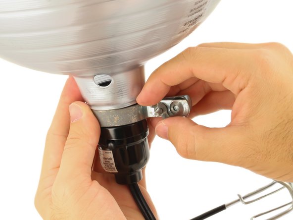

  2. How to Assemble the Student Lighting Kit: 2 단계, 이미지 3개 중 1개 How to Assemble the Student Lighting Kit: 2 단계, 이미지 3개 중 2개 How to Assemble the Student Lighting Kit: 2 단계, 이미지 3개 중 3개
    • Loosen the wing nut on the C-shaped mounting bracket.
    • Seat the bracket in the notch just under the reflector dome's base, and hold the bracket against the lightbulb housing.
    • Don't tighten the wing nut just yet, as the bracket will tighten over the work clamp.

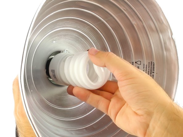

  5. How to Assemble the Student Lighting Kit: 5 단계, 이미지 3개 중 1개 How to Assemble the Student Lighting Kit: 5 단계, 이미지 3개 중 2개 How to Assemble the Student Lighting Kit: 5 단계, 이미지 3개 중 3개
    • Insert a lightbulb into the socket, then turn the bulb clockwise until snug.
