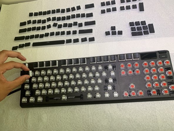

  3. How to Clean SteelSeries Apex Pro Gaming Keyboard: 3 단계, 이미지 2개 중 1개 How to Clean SteelSeries Apex Pro Gaming Keyboard: 3 단계, 이미지 2개 중 2개
    • Use your index finger and thumb to remove each key cap starting from left to right.
    • Remove the smaller key caps first so the surrounding larger key caps can be removed easier.
    • Place each key cap that was removed from the keyboard on a flat surface in order from left to right.

  7. How to Clean SteelSeries Apex Pro Gaming Keyboard: 7 단계, 이미지 3개 중 1개 How to Clean SteelSeries Apex Pro Gaming Keyboard: 7 단계, 이미지 3개 중 2개 How to Clean SteelSeries Apex Pro Gaming Keyboard: 7 단계, 이미지 3개 중 3개
    • Use your index finger and thumb to place the keycaps on the keyboard, starting from the top to the bottom.
