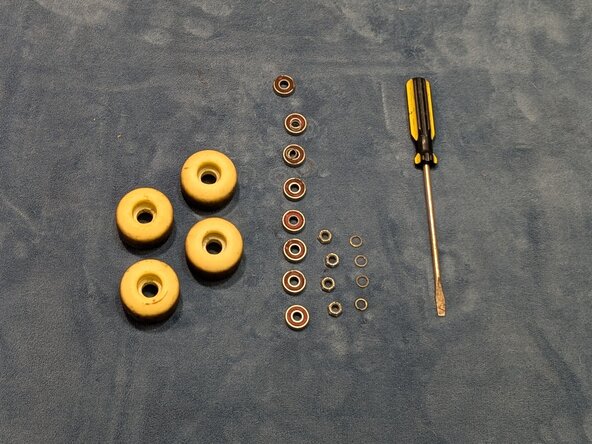

  1. How to Clean and Lubricate Skateboard Bearings, How to Clean and Lubricate Skateboard Bearings: 1 단계, 이미지 2개 중 1개 How to Clean and Lubricate Skateboard Bearings, How to Clean and Lubricate Skateboard Bearings: 1 단계, 이미지 2개 중 2개

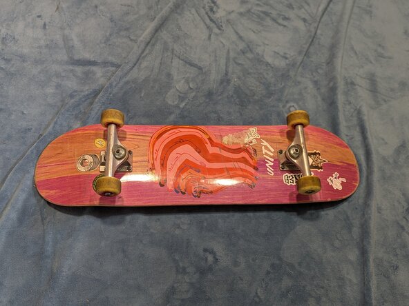

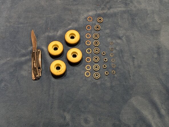

    • Remove the wheels from the skateboard by unscrewing the 8mm axle nuts with the adjustable wrench. Make sure to keep all your hardware organized so that nothing gets lost.
    • There should be four wheels, four nuts, and eight washers.

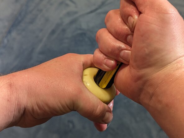

    • Pop the bearing out with a thin screwdriver. Go through the wheel to avoid damaging the bearings. Place the bearings next to the hardware.
    • Be careful not to push the screwdriver through the bearing into your hand.

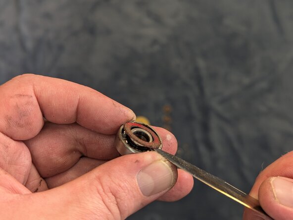

  3. How to Clean and Lubricate Skateboard Bearings: 3 단계, 이미지 3개 중 1개 How to Clean and Lubricate Skateboard Bearings: 3 단계, 이미지 3개 중 2개 How to Clean and Lubricate Skateboard Bearings: 3 단계, 이미지 3개 중 3개
    • Remove the bearing shield with a knife. Starting with the inside ring is the easiest method.
    • Use caution when using sharp tools.

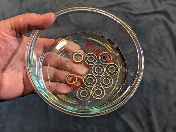

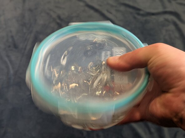

  4. How to Clean and Lubricate Skateboard Bearings: 4 단계, 이미지 3개 중 1개 How to Clean and Lubricate Skateboard Bearings: 4 단계, 이미지 3개 중 2개 How to Clean and Lubricate Skateboard Bearings: 4 단계, 이미지 3개 중 3개
    • Place the bearings and the shields in the container and pour mineral oil in until they are submerged. Place the lid on the container and give it a good shake.

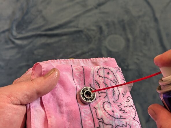

  6. How to Clean and Lubricate Skateboard Bearings: 6 단계, 이미지 2개 중 1개 How to Clean and Lubricate Skateboard Bearings: 6 단계, 이미지 2개 중 2개
    • Take the WD-40 and spray a little bit into each bearing.

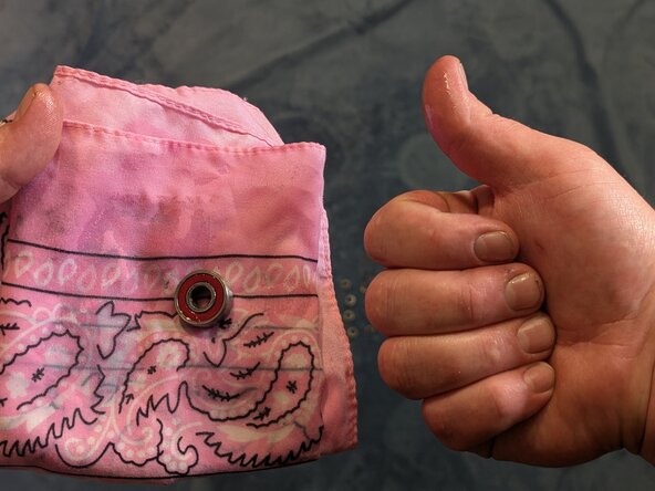

  7. How to Clean and Lubricate Skateboard Bearings: 7 단계, 이미지 3개 중 1개 How to Clean and Lubricate Skateboard Bearings: 7 단계, 이미지 3개 중 2개 How to Clean and Lubricate Skateboard Bearings: 7 단계, 이미지 3개 중 3개
    • Place the bearing shields back on the bearings by snapping them back in place.
