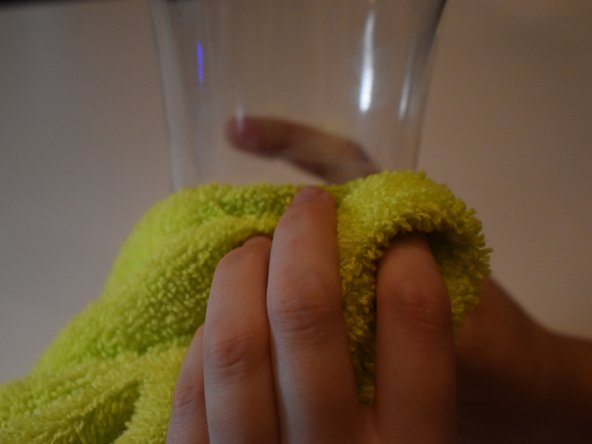

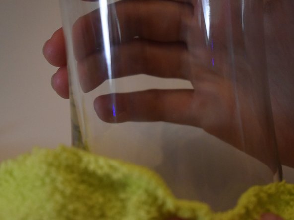

  1. How to Fill a Crack in a Glass Container, How to Fill a Crack in a Glass Container: 1 단계, 이미지 3개 중 1개 How to Fill a Crack in a Glass Container, How to Fill a Crack in a Glass Container: 1 단계, 이미지 3개 중 2개 How to Fill a Crack in a Glass Container, How to Fill a Crack in a Glass Container: 1 단계, 이미지 3개 중 3개
    • Clean the jar or vase with dish soap to remove all dust, fingerprints and dirt.
    • Using a tool such as a sponge or brush is optional but will work better than just your hands.
    • Dry the glass using a paper towel, and allow it time to completely dry.
