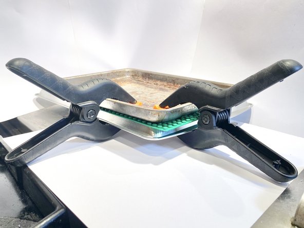

    • Quickly sandwich the baseplate between two flat baking pans while the baseplate is still warm.
    • You can use any two flat, sturdy objects if baking pans are unavailable.
  6. How to Fix Warped LEGO Baseplates: 6 단계, 이미지 2개 중 1개 How to Fix Warped LEGO Baseplates: 6 단계, 이미지 2개 중 2개
    • Place two plastic clamps over the two pans to evenly apply firm pressure against the baseplate.
    • If clamps are unavailable, you can use weights to apply similar pressure.
    • Leave the LEGO baseplate in between the pressure of the baking pans for at least 5 hours.
결론
If your LEGO baseplate is still warped after the 5 hours of sitting in between the clamps, repeat process and leave the LEGO baseplate in between clamps for an additional 5 hours.
