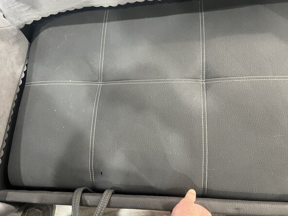

    • Locate the area of the couch that appears to be dented or warped.

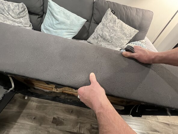

    • Open the internal compartment of the couch in the specific area that was dented.
    • To access the internal compartment of your couch, remove any seat cushions, then locate and unzip, or detach the fabric lining underneath. If the frame has a panel, unscrew or unclip it as needed. Most compartments are underneath, so check if it lifts open.
    • This step may require removing the dust cloth with a pair of scissors from underneath the couch.

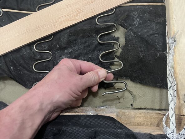

    • Locate the dislodged couch spring.
    • There may be multiple springs or just one out of place.
  4. How to Fix a Dislodged Couch Spring: 4 단계, 이미지 1개 중 1개
    • With the help of a partner (optional), hold the couch spring down, and reinsert the tip into the socket.
    • This may be done with the use of pliers if there is too much tension on the spring for you to hold.
  5. How to Fix a Dislodged Couch Spring: 5 단계, 이미지 2개 중 1개 How to Fix a Dislodged Couch Spring: 5 단계, 이미지 2개 중 2개
    • After inserting the tip of the spring into the socket, try pushing the spring fully into place. If needed, ask a partner to assist with the process.
    • This step may require the use of a mallet to force the spring back in.
    • After the tip of the spring is inserted, keep applying tension so that it stays in place.
  6. How to Fix a Dislodged Couch Spring: 6 단계, 이미지 1개 중 1개
    • Once the head of the spring has been fully inserted into the socket, ensure that the rest of the spring is properly positioned and that no other parts are flaring out.
    • If necessary, repeat the previous steps on any other dislodged springs until they are all in place.
