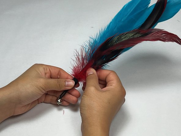

  5. How to Fix a Feather Cat Toy: 5 단계, 이미지 2개 중 1개 How to Fix a Feather Cat Toy: 5 단계, 이미지 2개 중 2개
    • Individually insert the quill of each feather into the capsule.
    • Work quickly so that the glue doesn’t dry and cause the feathers to stick in the wrong direction.
