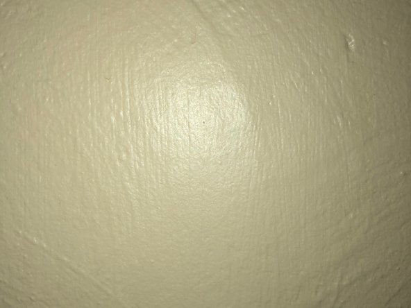

    • Use pliers (or tweezers if the hole is very small) to clean out hole by removing the drywall out of the hole.

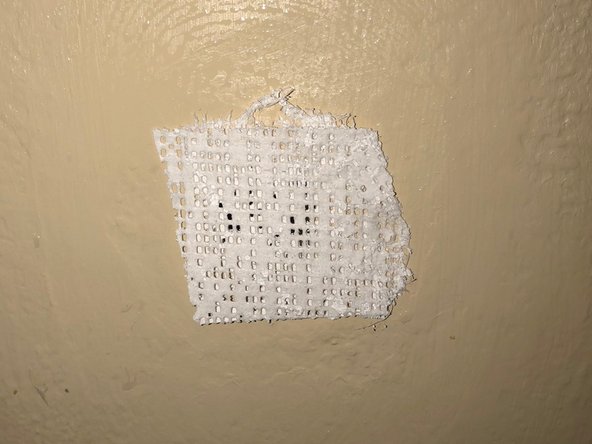

  3. How to Fix a Hole In Wall: 3 단계, 이미지 2개 중 1개 How to Fix a Hole In Wall: 3 단계, 이미지 2개 중 2개
    • Use a damp sponge to apply moisture to make the mesh stick to the wall, covering the entire hole.
