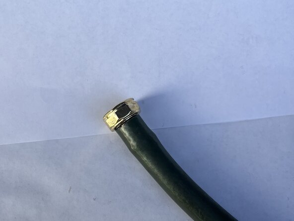

    • Disconnect the hose and place the end on a stable surface.
  2. How to Fix a Leaking Garden Hose Connector: 2 단계, 이미지 2개 중 1개 How to Fix a Leaking Garden Hose Connector: 2 단계, 이미지 2개 중 2개

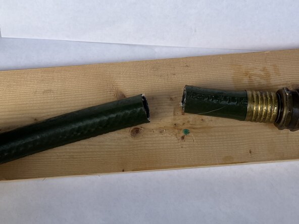

    • Hold the hose down against the surface and use the utility knife to cut the hose about two to three inches away from the old connector.
    • Be careful cutting through the hose as the utility knife is very sharp and the hose is thick.
  3. How to Fix a Leaking Garden Hose Connector: 3 단계, 이미지 3개 중 1개 How to Fix a Leaking Garden Hose Connector: 3 단계, 이미지 3개 중 2개 How to Fix a Leaking Garden Hose Connector: 3 단계, 이미지 3개 중 3개
    • Insert the new male hose connector into the open end of the hose, pressing it in by hand as far as possible.
    • Use the pliers to assist with pushing the connector completely into the hose.
    • Make sure the connector is fit completely to the edge of the hose.

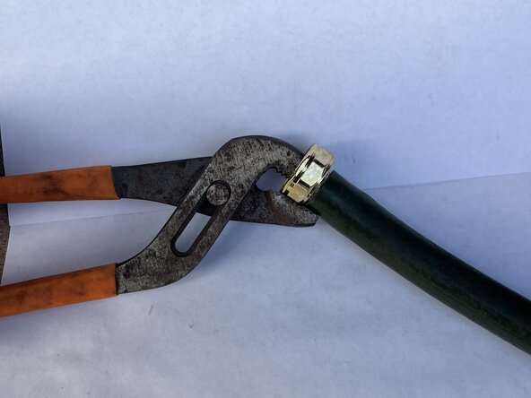

    • Take the stainless steel clamp and loosen the screw by hand or with the pliers until it will slide around the hose.
  5. How to Fix a Leaking Garden Hose Connector: 5 단계, 이미지 2개 중 1개 How to Fix a Leaking Garden Hose Connector: 5 단계, 이미지 2개 중 2개
    • Place the clamp close to the connector but not too close, and begin to tighten it by turning the screw on the clamp.
    • Use the pliers once it starts to get harder or a flathead screwdriver if you have one.

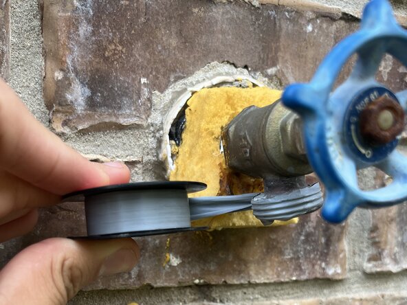

    • To make sure there are no other leaks between the connector and the spout, wrap Teflon tape around the thread of your water source 2-3 times.
    • Twist the new hose connector to the water source.
    • Do this by hand or with the pliers until it is secure.
    • Finally, turn the water on and make sure there are no leaks from the new connector.
